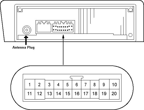

Hi.
I have a 2005 Honda Civic ValuePackage (don't laugh). I'm planning to purchase a new head unit and install it myself. When looking at the wiring diagram from the new head unit (Pioneer DEHP3900MP) and the vehicle wiring chart from the12volt.com ... http://www.the12volt.com/installbay/....asp~TID~86090 ... it appears as though there are more wires to connect to the factory stereo than the new aftermarket one. What do I do with the leftover stereo parts?
My car should have these wires (no tweeters installed):
+12V DC Battery(Constant), Switched Accessory, Ground, Illumination, Left Front +, Left Front -, Right Front +, Right Front -, Left Rear +, Left Rear -, Right Rear +, Right Rear -...
There is no mention of an antenna plug on the12volt ... i do have one separate that will fit my new Pioneer HU, right?
What do I do with the "Illumination" wire? Leave it unplugged from anything? ... please don't mention a wiring harness, I am going to do without. Don't worry, I am going to keep the factory wiring harness with the factory stereo, should I ever want to put it back in. Thank you for your respect of my wishes, and your help!

Oh shoot, that was my other question. Can I just connect the ground wire from the car to the ground wire on the Pioneer wiring harness that comes with the HU?

Re: 2005 Honda Civic stereo wiring question (specific)
ok so you do know u still have to cut off the connector if arent going to use a harness. i suggest u break down, buy a cheap harness and make things so much easier. but are u saying ur new deck doesnt have an illumination wire? and ur antenna wire is separate from the harness. ur ground wire should be in the harness. maybe this will help
Cavity Wire Connects to
1 YEL/GRN Antenna module
2 YEL/RED ACC (Main stereo power supply)
3 - Not used
4 - Not used
5 PNK Right rear speaker (+)
6 BLU/WHT Left rear speaker (+)
7 GRN/YEL Passenger's door speaker (+), Right tweeter (+)
8 GRN/BLK Driver's door speaker (+), Left tweeter (+)
9 RED/BLK Lights-on signal
10 WHT/RED Constant power
11 - Not used
12 - Not used
13 - Not used
14 - Not used
15 BLU/YEL Right rear speaker (-)
16 BLU/BLK Left rear speaker (-)
17 GRY/RED Passenger's door speaker (-), Right tweeter (-)
18 LT GRN Driver's door speaker (-), Left tweeter (-)
19 RED Dash lights brightness controller
20 BLK Ground (G503)

Yep, it was a very bad decision to go this route. I'm in the same boat as Speedfoos, some jackass hard wired the radio before I got the car. I don't know if it was stolen or if the installer was just a retarded *******. Maybe both.
Anyway, can someone explain the function of Pin 1 for me? Is this to power the antenna booster or whatever it is? I'm having real shitty radio reception and i have a feeling that because they hard-wired, might have left it disconnected.
If this IS the pin that powers the antenna booster, would I hook it to....the power antenna lead on the radio, or what exactly?
yes.

Well, I hooked the remote turn on / power antenna wire (blue) from the back of the radio to pin 1, expecting this to power up tue antenna booster and give me radio reception, but, no such luck. No dice.
