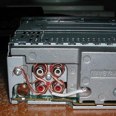

Okay the doc is in. Here is what you have pioneer head units are known for the week rca grounding. So here is what you are going to do. Your going to take pieces or wire dosent matter if its 14 gauge or 16 gauge. And you are going to wrap a piece around your "grounding screw" than the other part you are going to wrap around the rca plugs. This should get rid of your noise. I could go into massive details on why this happens but I am not.If it still a curs after doing this than I might have to make an on site appearance. Here is a pick on what I am talking about.

I understand that that fixes the symptoms, however why is it that with my Pyle head unit that same technique doesn't work?
I'd rather get the problem fixed, than hidden.

It dose not hide the problem. If you were to go buy a alpine head unit and install it you would not have this problem. The fact as I stated is that all pioneers have week grounding points on there rca's thats why you are getting the noise if they have a better ground than it will go away. This is what you have to do. Belive me I use to have a ppioneer in my 1999 honda civic and had the problem I didn't want to do that wire trick becasue I though it was a stupid to try but it works. But I got smart and found out that alpines are better so I went with them.

I am currently using a Pyle because my Pioneer died and is out for repairs. I have the same problem with a Pyle, I also tried another headunit which was a Sony with the same problem. The problem introduced itself with the bad cap install, before that my Pioneer and all my other head units worked really well.
