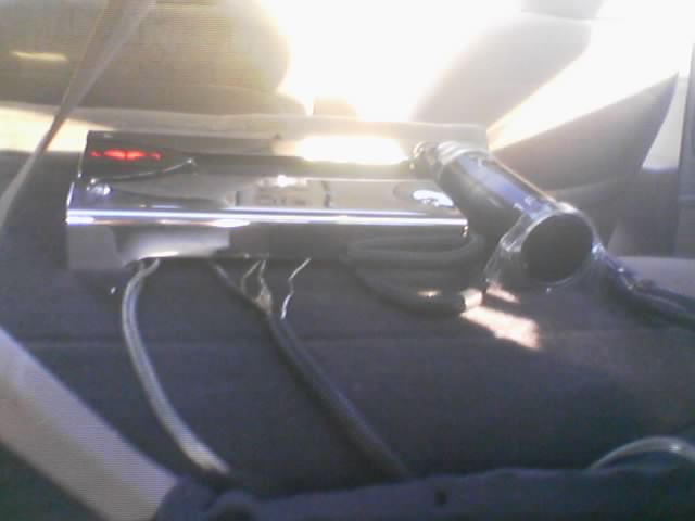

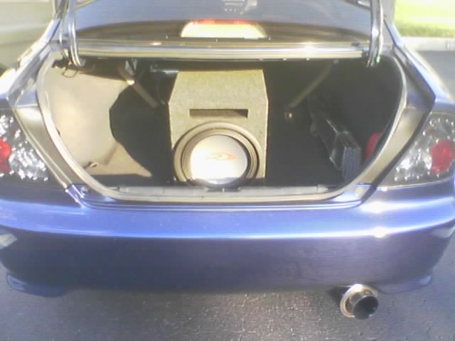

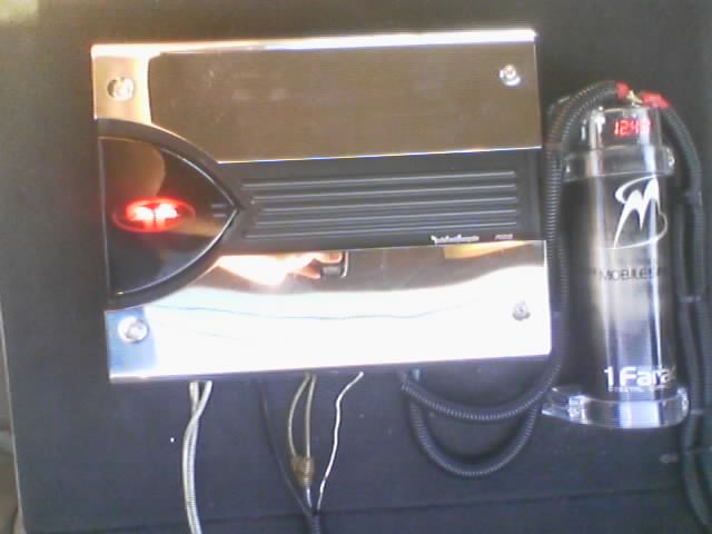

some pictures of the install and some other randoms....
working well now that I have it hooked up right....it kept shutting off since it was bridged and not wired properly... "haste makes waste!"

Very clean & simple setup I like!

looks good. simple and to the point, just how I like it. How do you like running one 12? I am currently running a pair of 10s and am thinking of goin to a single 12, mainly for space constraints. im tired of only having half a trunk.

Re: my alpine type r
single 12 is what I have always had...... the reason I love it so much is really that box......that thing is crazy...it will make any sub sound great
