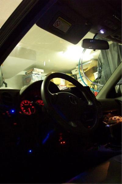

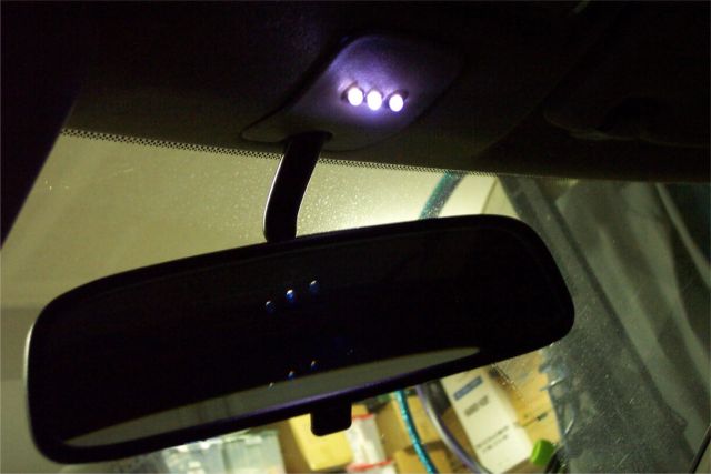

orrrrrrr... for another option. use leds with an external switch somewhere else.
i find factory map lights are way too bright. and useless in the dark for reading your mapquest directions or whatnot. i use 3 white LEDS mounted up top (mine is mounted on the cover for the mirror.. but i drive an rsx) so if you have something similar to mount it to up there, mount it there. then run wires down to a switch/fuse/relay(if you want, but its relatively low power consumption so switch+fuse should be fine)

well you cant even notice my LED's unless you really look for them. lets see if i have a picture...
found one... again this is in my rsx, not to get confused with anything else.

that looks kinda dim... does it manage to light up bright enough? I wouldnt mind it being bright, since thats why i need the light for.
Did you just pop off the cover and glue the LED's on?

the pictures dont do it justice since obviously theres brighter lights in the pictures.
the lights are bright enough to see mapquest directions anywhere in the center console area. If you want more light, simply add more LED's
i removed the cover, drilled holes, and used little LED holders that hold the led in place. no glue. best part is, you dont notice it unless you are really looking for it.

I dunno, if you wanted to go with that idea, I think you could get a led that focuses the light tightly and sink them in the cover a little better. Anyways. There is a bracket thats welded the the headliner. You should take a pic of your DX headliner- the area where the map lights would go, with the rear view mirror as a refereance point. I could tell you whats up then. You mgiht wanna go ahead and buy the LX headliner, i think it might be 50 bucks from majestic- or in that ballpark. It would probably make your life easier. the map lights themselves are about 1.5-2 inches thick, and thats not counting the bracket that they screw into. As for the wiring, its just a postivie 12v wire that comes up the drivers pillar. There is no ground wire that comes up, because the screw that holds the map light assembly to the metal bracket doubles as the ground. If you take off your headliner and peek under neath- you might have the bracket on there allready- I wouldnt be too suprised.
