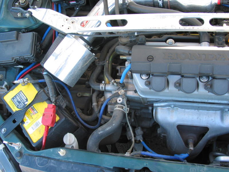

Big 3 meaning replacing the 3 stock grounding wires? Here you can see some pix of my engine compartment.

I'd leave the 5AWG on the profile amp and use the 4AWG into a cap just for the sub amp. A mid/high amp won't pull near the amount of power that sub amp will.
