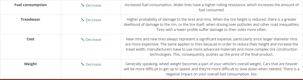

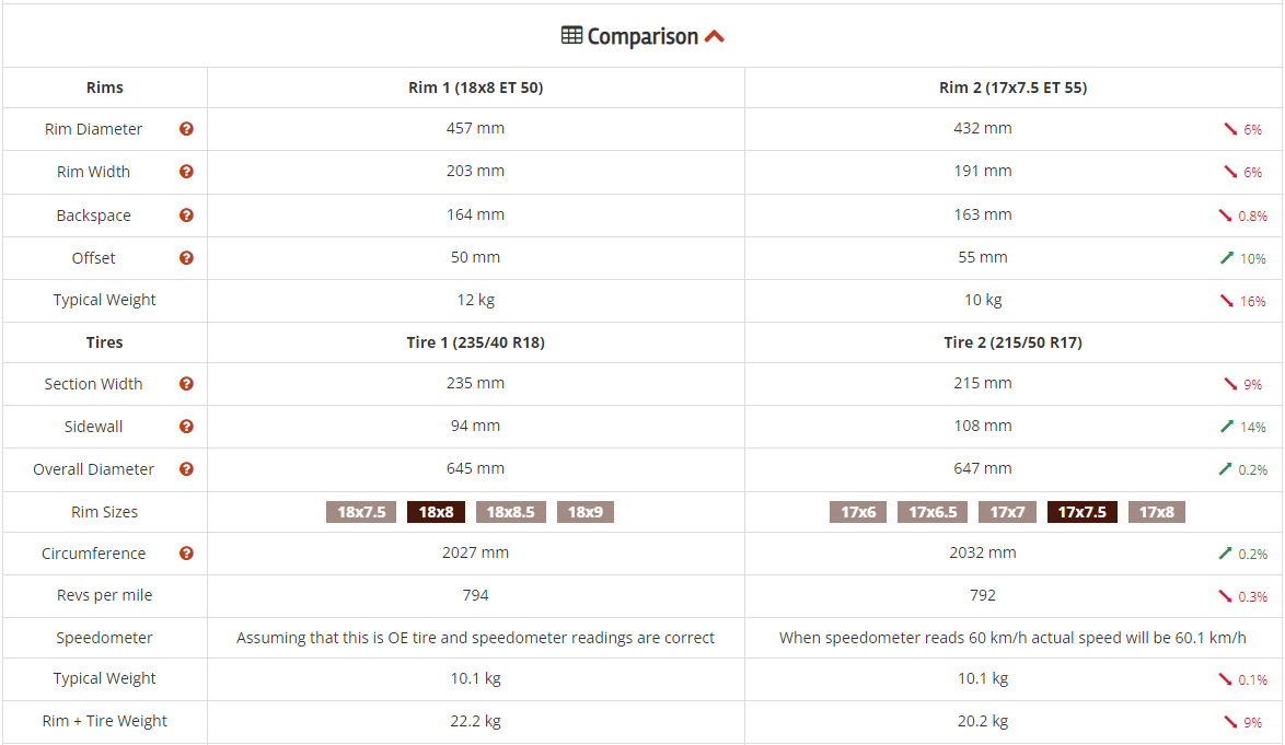

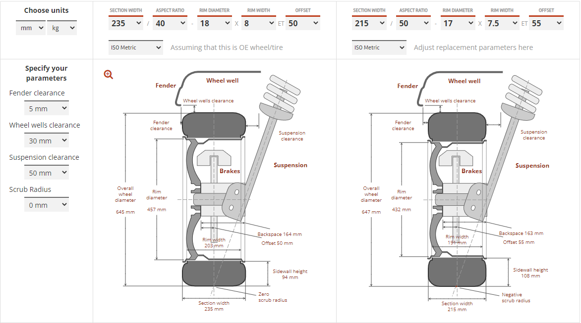

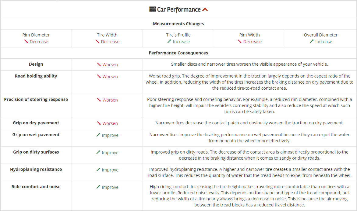

Alright.. So the Accord Sport 17's are 215/55-17 with 17x7.5 ET55, and the 17 Si OEM rims are 234/40-18 18x8 et50s.
Assuming you wrap that accord rim in 215/50-17's (the OEM size for 10thgens that came stock with 17s...
Source: wheel-size.com

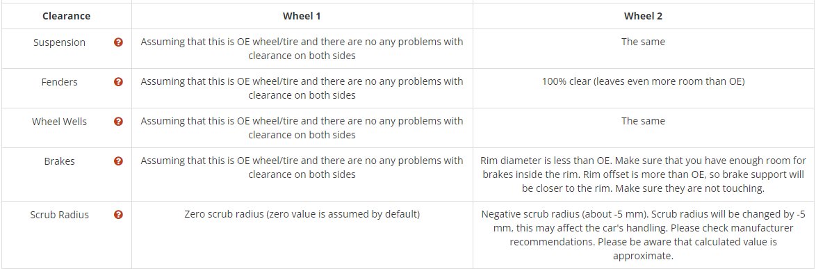

Now, take into consideration that, since 215/50's are OEM 10thgen 17 wheels, pretty much everything in the "performance" category is going to be negligible changes. The section you'll want to pay attention to is the "clearance" section. The only thing that may be worrisome is the brake clearance behind the rim. The only real way to test that is to try it out. Put the front end up in the air, swap a rim, and rotate slowly to check caliper clearance. You
shouldn't
have any issues, but it's better to be safe than sorry. edit: as long as it's not scraping the caliper, you should be fine. I've seen rims be fine with literally 1-2mm caliper clearance

np. Inner shoulder clearance should be fine, but again, check to make sure with the front end in the air and turn to full wheel lock left and right. Despite being 5mm deeper into the wheel well, it's 20mm thinner, so I highly doubt inner shoulder rubbing would pose an issue
for future reference, wheel-size.com is my go-to site for wheel and tire comparisons because you can find OEM wheel specs and get that whole laundry list of comparisons that I copied and pasted above
