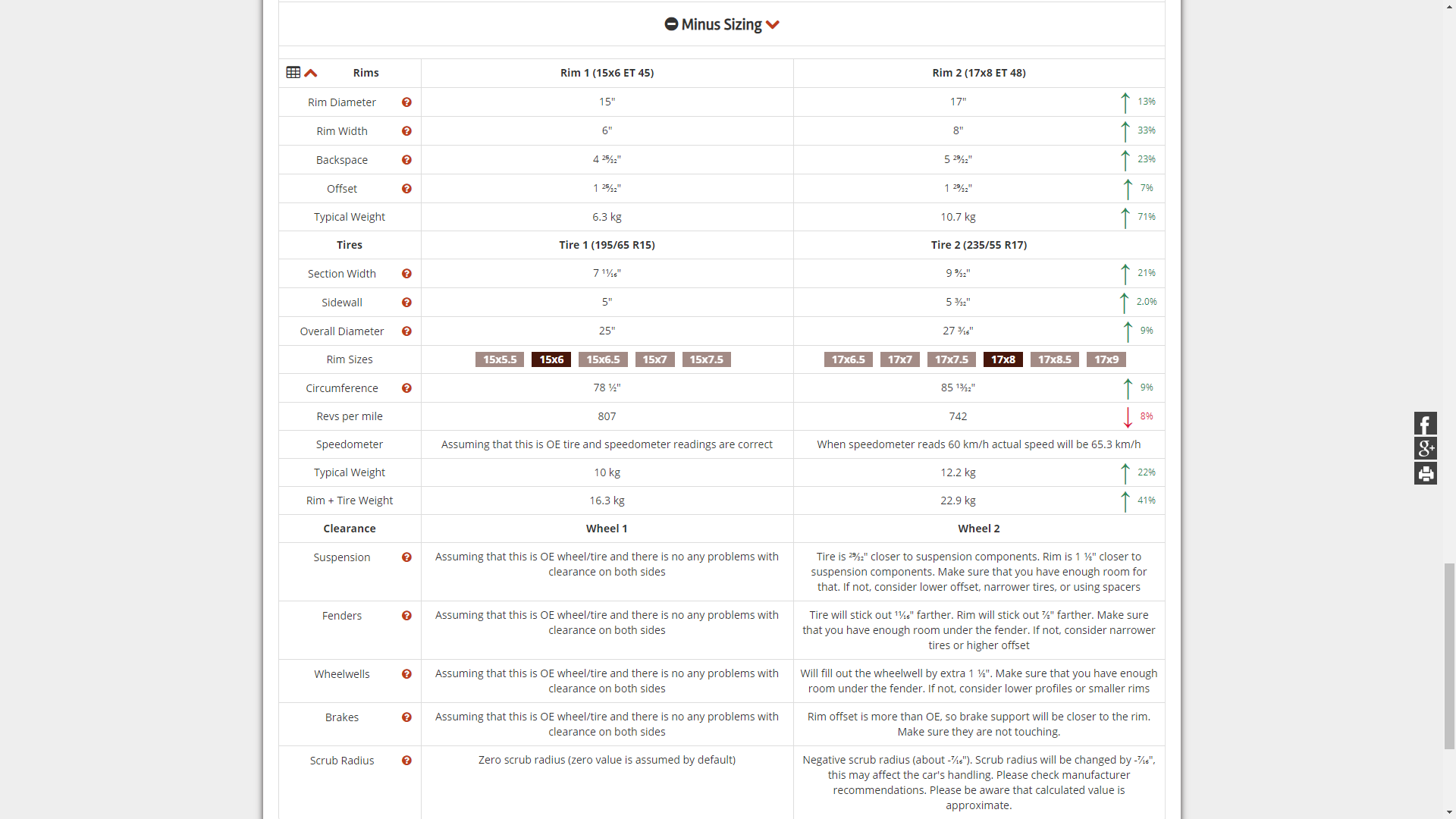

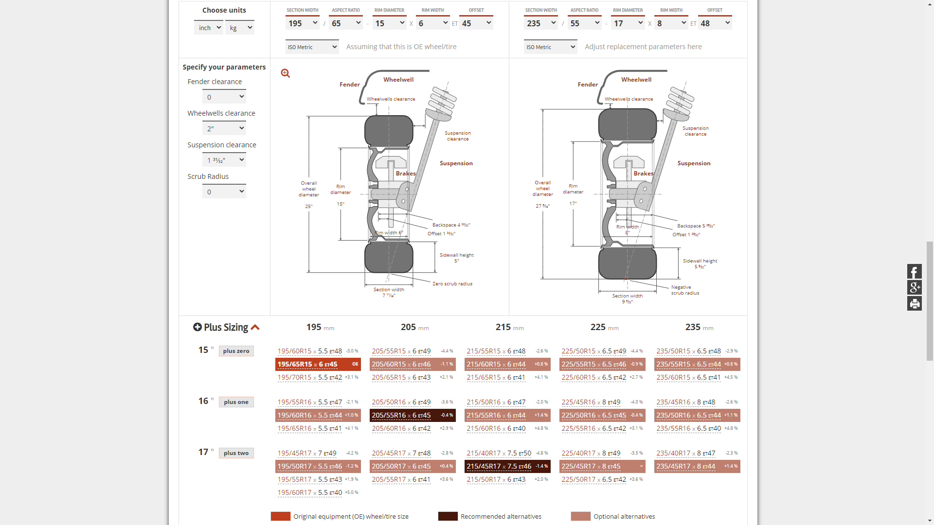

There's another wheel size calculator that gives you a visual representation of where any possible rub points would be. You would have to adjust the original fender clearance, wheelwell clearance, suspension clearance, scrub radius parameters to see what you'd be looking at, however. Eyeballing some other pics online of people rocking 234-45's, this is what you're looking at with no spacers. The "Specify your parameters" section is all approximate, just fyi. Also kinda guessed on the new rim width and put the max offset bc those specs weren't specified.
