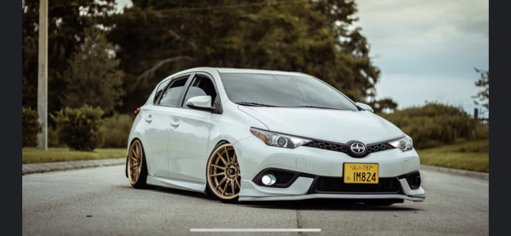

Que sugerencias me pueden dar para comprar rims y tires para mi civic como el carro de la foto, para posteriormente bajar su altura lo más posible , gracias ,quiero usar rims 18” con llanta de 35 mm de altura , pro low, he escuchado que atrás el rims va más pequeño para que baje más
What suggestions can you give me to buy rims and tires for my civic as the car in the photo, to subsequently lower its height as much as possible, thanks, I want to use rims 18” with , 35 mm high tire, pro low, I have heard that behind the rims goes smaller to lower more

If you get too low of a profile, you start to mess with things like the speed sensors/speedometer. Also, with super low profile, you get a super rough ride. If you want super low profile, get a bigger rim. 20s should fit if you wanna go that route.
20" x 9" rims wrapped in 275/25-20's will give you a 69mm sidewall height and not mess with, well, anything

using different OD tires also will mess up the ABS - they will trigger. Don't ask me why i know.

thank you very much, I came to change the shock absorbers for shorter and more rigid, I do not want the tire to enter the fender, just flush.

If you have it sit flush when you're not moving, it's gonna tuck any time you hit a bump. Just keep that in mind

for that same reason, I must install more rigid shock absorbers to prevent wear on the wheels
