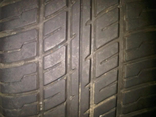

Winter tires definitely help on icy hills, they've saved me many times. All-season tires use a tread pattern that allows snow to be trapped in the tread, essentially making the tire perform as if it were bald; the tread pattern of winters prevents snow from packing onto the tire. Winter tires also use a much softer tread compound, so when its freezing the rubber remains soft and sticky. The tire compound of all-seasons freezes and becomes hard, removing the ability to grab onto the road.
Chains help a bit on the ice but not much, they're more helpful in deep snow where they have something to grab onto.
I will have to just add the tread pattern design.
the blocks are all cut all the way down, so they will flet a whole lot more than all seasons and summer tires.
The more they flet, the less they are sliding in the ground.
Naturally, all the above will make them last much less.
Thanks for adding that! I meant to include that in my post, but forum responses on my essay writing break equals fail.

For those of you who aren't familiar with the difference in tire types I thought I supplement my earlier posts with some pictures. Hopefully this will be of benefit to some of you.
Summer Tire- Notice the long unending channels in the rubber, they improve the tires grip during the summer. In the winter however, snow can be packed into them very easily, which is why summer tires are dangerous to use in winter.
