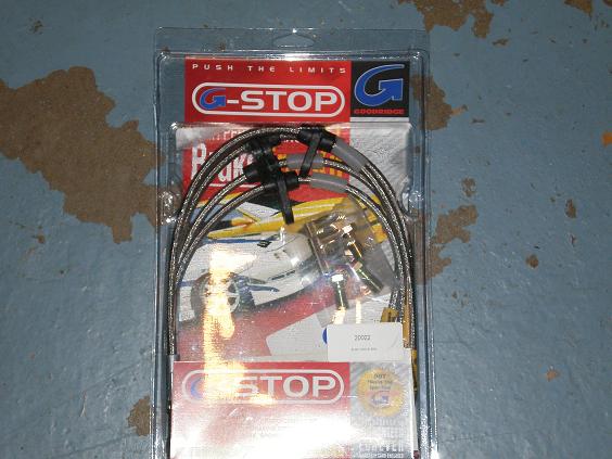

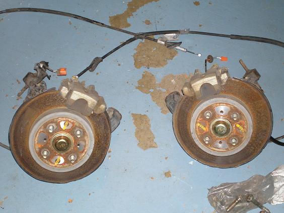

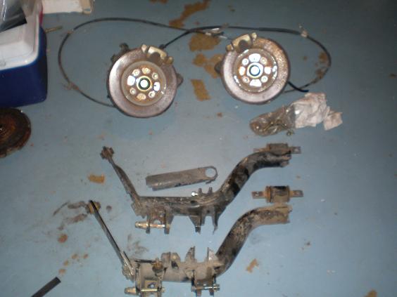

This is something that I wish I would have done with my Kswap, but the process was to intense and time consuming to do a step by step process. I know that there is a DIY on this, but I thought I would go to it every step of the way from begining to end.
Today I have just recieved my swap in the mail This was a very hard item to find I ended up getting the brakes from an 02 Si with less than 50K on it. They were shipped all the way to Ohio from Oregon. When buying them I specified that they had to be 4 lug (for those that don't know the newer models 04 and 05 civic Si had 5 lug brakes) and I needed everything including the e-brake cables and any hardware. Well, as you can tell from the pics I got everything and much much more LOL. I will not use half of the stuff that I got, but it is always good to have extra parts laying around. What I don't use (the entire lower control/rear tie assembly) will be sold on ebay.
I ended up getting all of this for $375 shipped, which considering that it weighted 125lbs I figured this was not to bad of a deal. Also pictured are the stainless lines that I will install on both the front and rear brakes ($100).
Still left to buy are hawk hps pads for the rear to match the ones on the front ~$50, motal DOT 4 fluid ~$12 a bottle x3, and to get these rotors turned ~$12 (asided from the rust they actually look really good).

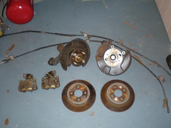

Ok I now have everything taken apart and the parts that I need sorted from the parts that I don't. The pics are the parts that I will need, and as you can see I recived alot more parts than I needed. The total time it took to disassemble the brakes was roughly 30 min. The next step will be to clean everything up, check everything out to be sure that it is performing properly, fix the bent dustshields, paint the calipers, get the rotors turned, order new pads, and then reassemble everything.
