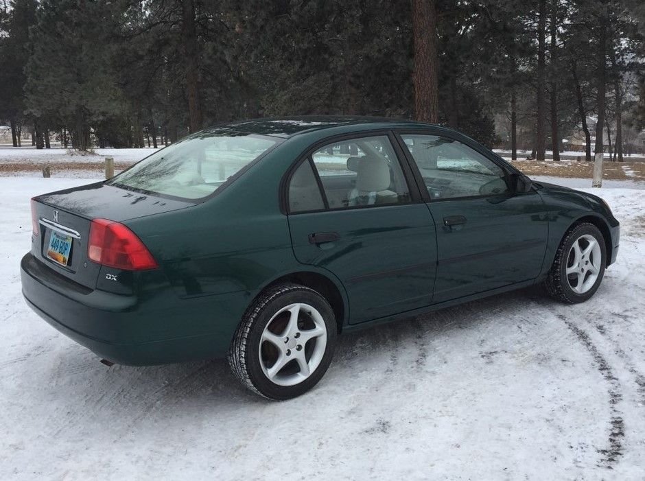

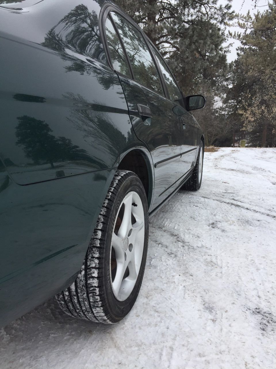

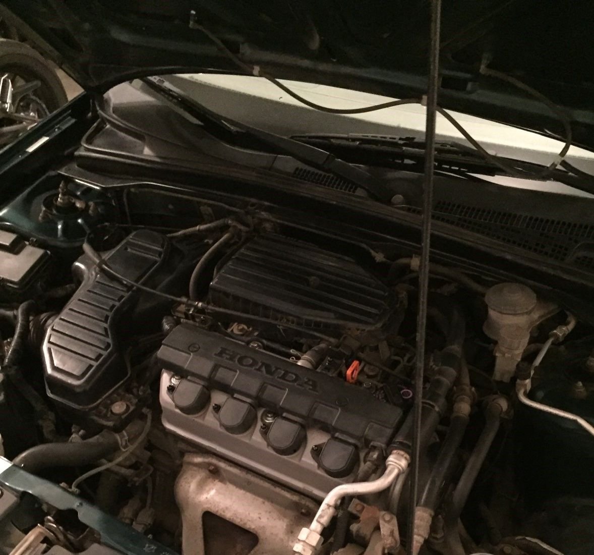

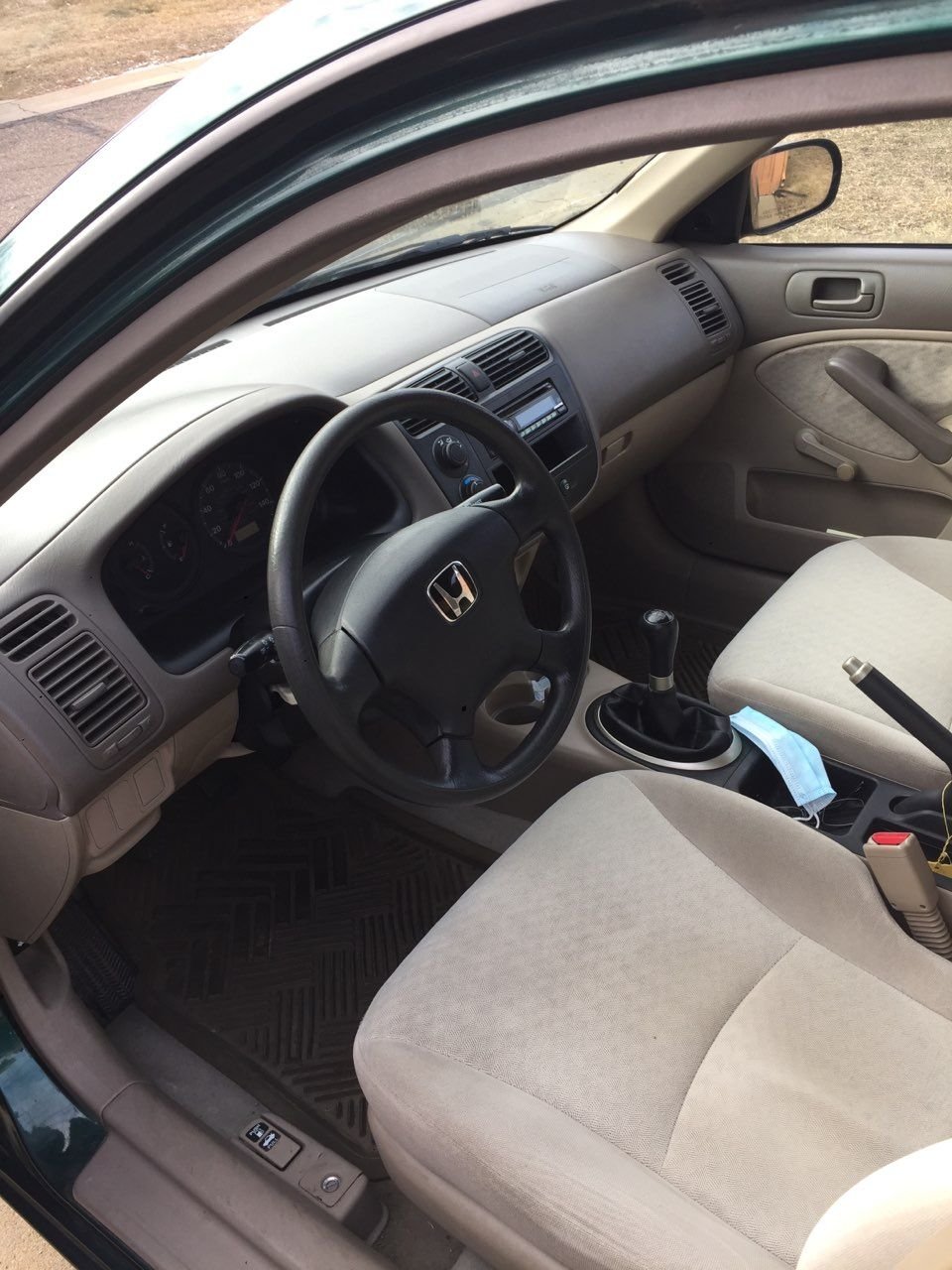

New member here. My brother sold this to me last month -- he was the original owner since new. He moved to Ireland about 5 years ago, but kept the Civic for when he returned to the U.S., but hasn't been back much in the last couple of years so figured it was time to let it go. He wanted me to have it, so he gave me a very good price -- 1000 bucks.
I didn't really need another car; I also have an '03 Honda Element EX AWD and a 2018 Volkswagen Golf Alltrack, but I thought what the heck, it's only a grand, why not. The car was very well maintained and despite all the sitting it did the last 5 years it runs excellent. It has 167k miles. I just had the oil changed, synthetic Mobil 1 as that's what my brother always used. I've put about 1000 miles on it so far and it hasn't used any oil so that's a great sign. The clutch feels great despite being original (my brother drove the car like a grandpa) and the transmission still feels crisp with no popouts or other issues. It had new struts put on about 3 years/2k miles ago so that's one expense I won't have to deal with. There's no rust anywhere on the body, but the steel wheels have some surface rust. The Honda dealer that changed the oil gave the car a thorough inspection and seemed surprised that it didn't have any oil leaks anywhere. The only thing they noted was a cracked windshield and old, worn-out tires.
The timing belt was changed 64k miles ago, but that was in '06, so I'm getting the timing belt, tensioner, other belts and water pump changed in a couple of weeks. Also the valve cover gasket and some other seals that came with the timing kit (all OEM) that I purchased. Also going to have a valve inspection/adjustment done, and change the spark plugs as they are also 14 years old and changed with timing belt in '06. I almost hesitate to get the work done as it runs so strong as is, but I know the car will easily go another 160k miles if those things are done. I also picked up some sweet, nice condition 16" rims I'm going to put on it as the current tires are old Cooper winter tires -- the fronts aren't too bad, but the rears are older and starting to dry rot. Anyways, the 16s are from an '02 Miata. All the specs will work with the Civic, except I'm going to have to get the center bore reamed 2mm to fit the Civic hub.
A couple of common 7th gen issues have been addressed. The headliner was sagging at both ends so I re-glued and tightened it up, and also replaced the sun visors with nice used ones as they were falling apart. Of course the gas cap cable doesn't work at the interior lever so I have to open it through the trunk. I'm aware there's a fix kit available so I may fix that at some point down the road. The clutch pedal was squeeking so I lubed it with some white lithium grease and that seems to have cured it. I spent about 10 hours cleaning the paint (cleaner wax) and interior and it turned out great. Seeing other 7th gen Civics out on the road has made me realize what nice condition this car is in.
My first car in 1981 was a '77 Honda Civic so I guess I've come full circle. This is the 4th Civic I've owned and I'm really having a lot of fun with it. Also been a while since I've had a manual transmission and I'd forgotten how great they are. I've always loved Honda shifters. Anyways, pictures below!

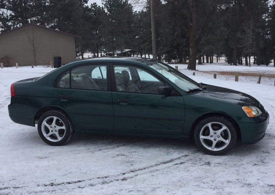

I finally got the Miata wheels mounted on Friday; they went on and balanced with the new tires with no issues. I think they have really improved the looks of the car. As you can see in the last picture they sit quite flush with the fenders, better than I expected they would.

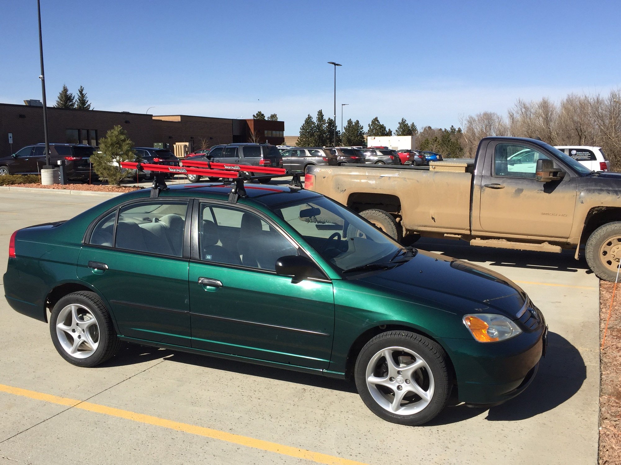

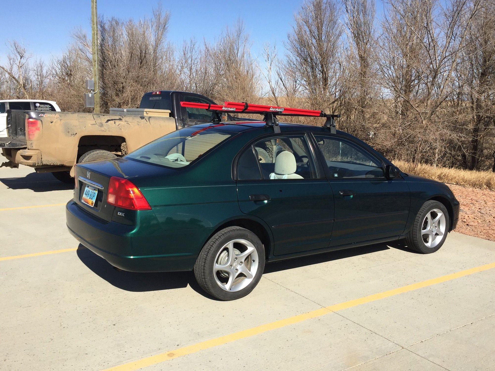

So a quick little update on the Civic. I might not have mentioned it earlier, but when I bought the car it came with the rack pictured below. It was the heart of winter so I took it off to save a little wind resistance and cabin noise. I got a wild hair this week and put it back on. I can only use one of the trays as is for my gravel bike, but with some fat bike adaptor gizmos I should be able to use both trays for my plus and fat bikes. I think it looks pretty good with the red trays.
The rear drum brakes, front hubs and calipers were pretty rusty, so I took the time to treat the rear drum and front hub/caliper with some POR 15 metal-ready and POR 15 silver paint. I painted the calipers in POR 15 black. I thought about going red, but thought it might look kind of weird since there are no calipers in the back to paint; I've seen drums painted red, but just think it's too much -- not to mention, I don't want to really draw any extra attention to the rear drums, haha. Now all I really have left to do is a new windshield, and maybe get a few little dents and dings repaired, but none bother me too much so not in any real hurry for now. Anyways, pictures:
