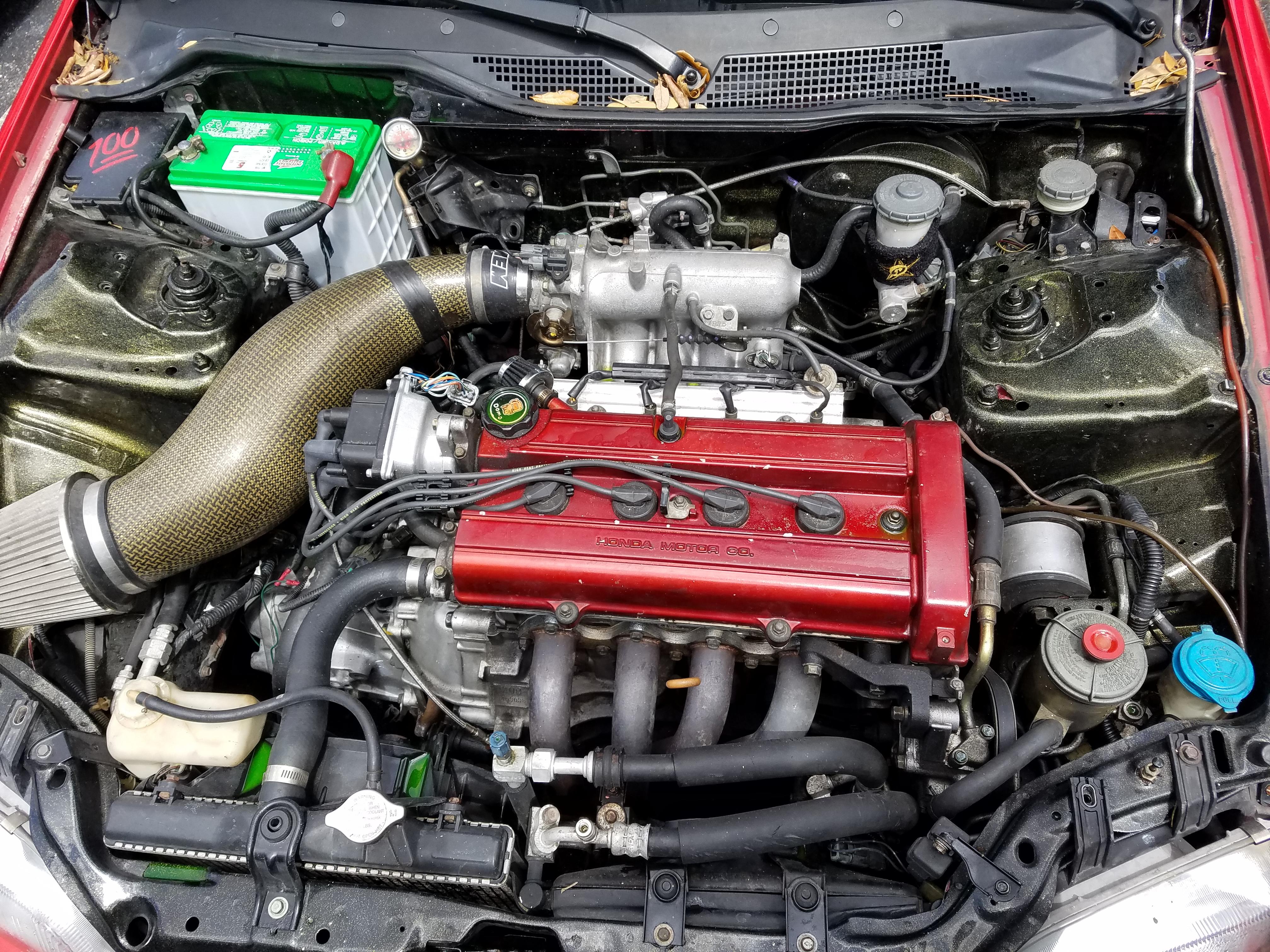

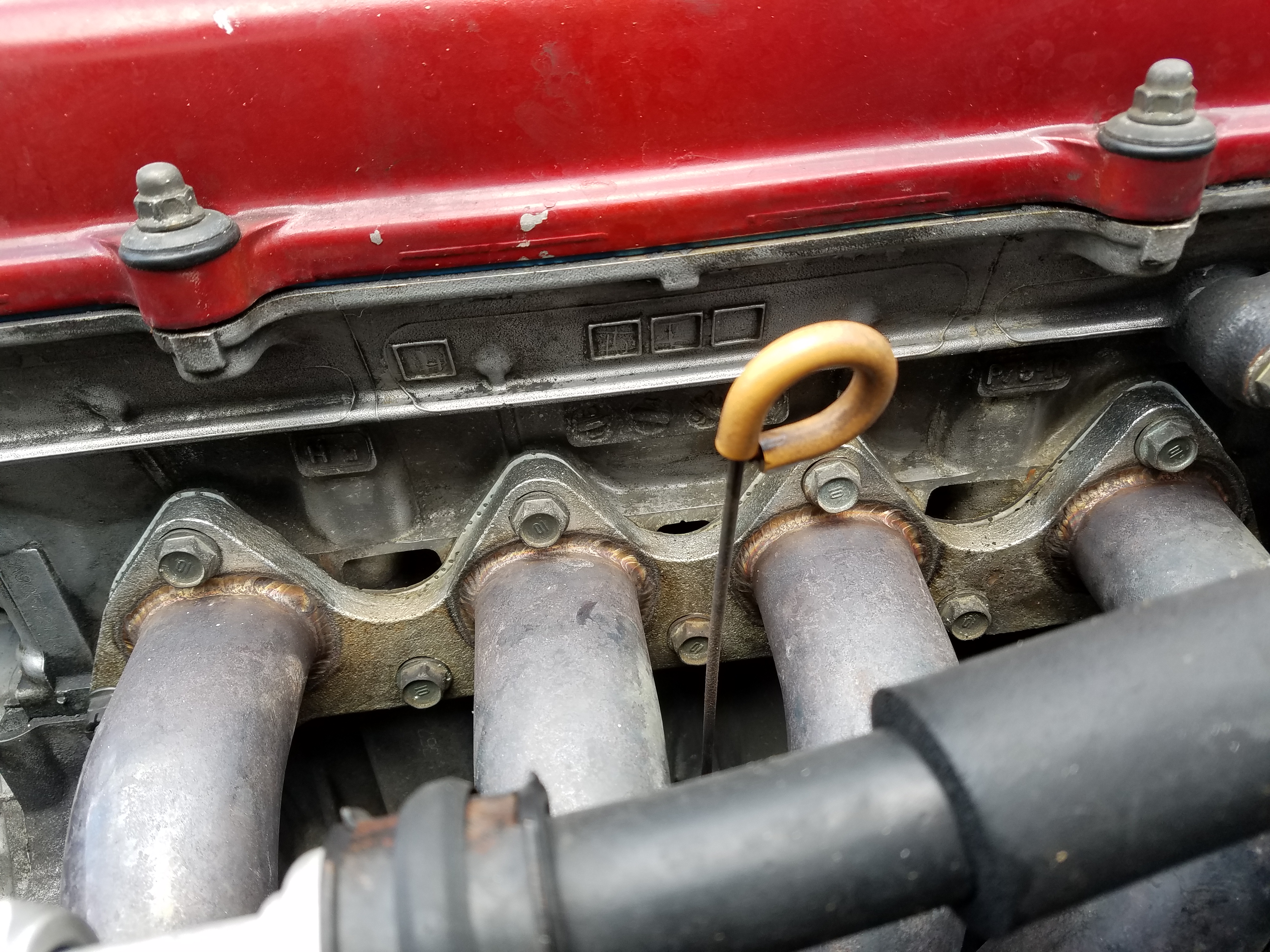

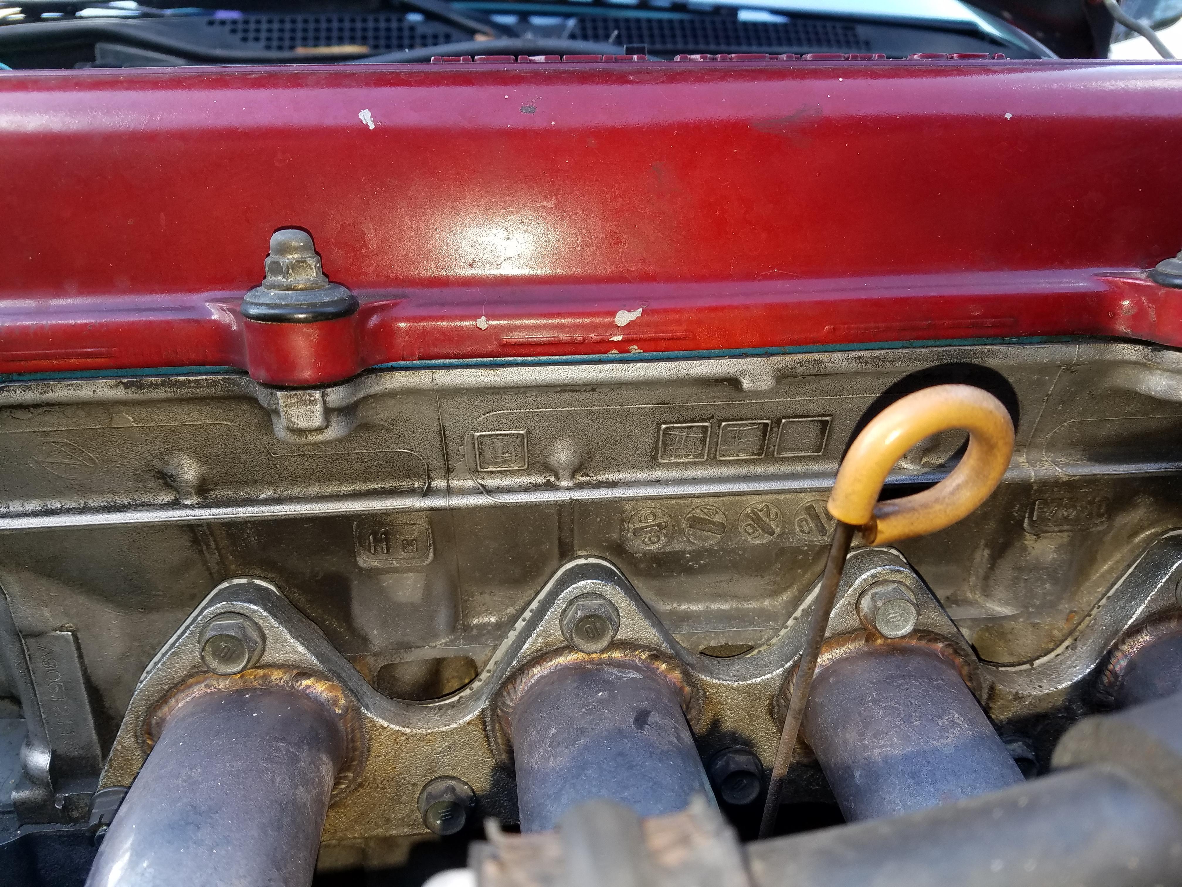

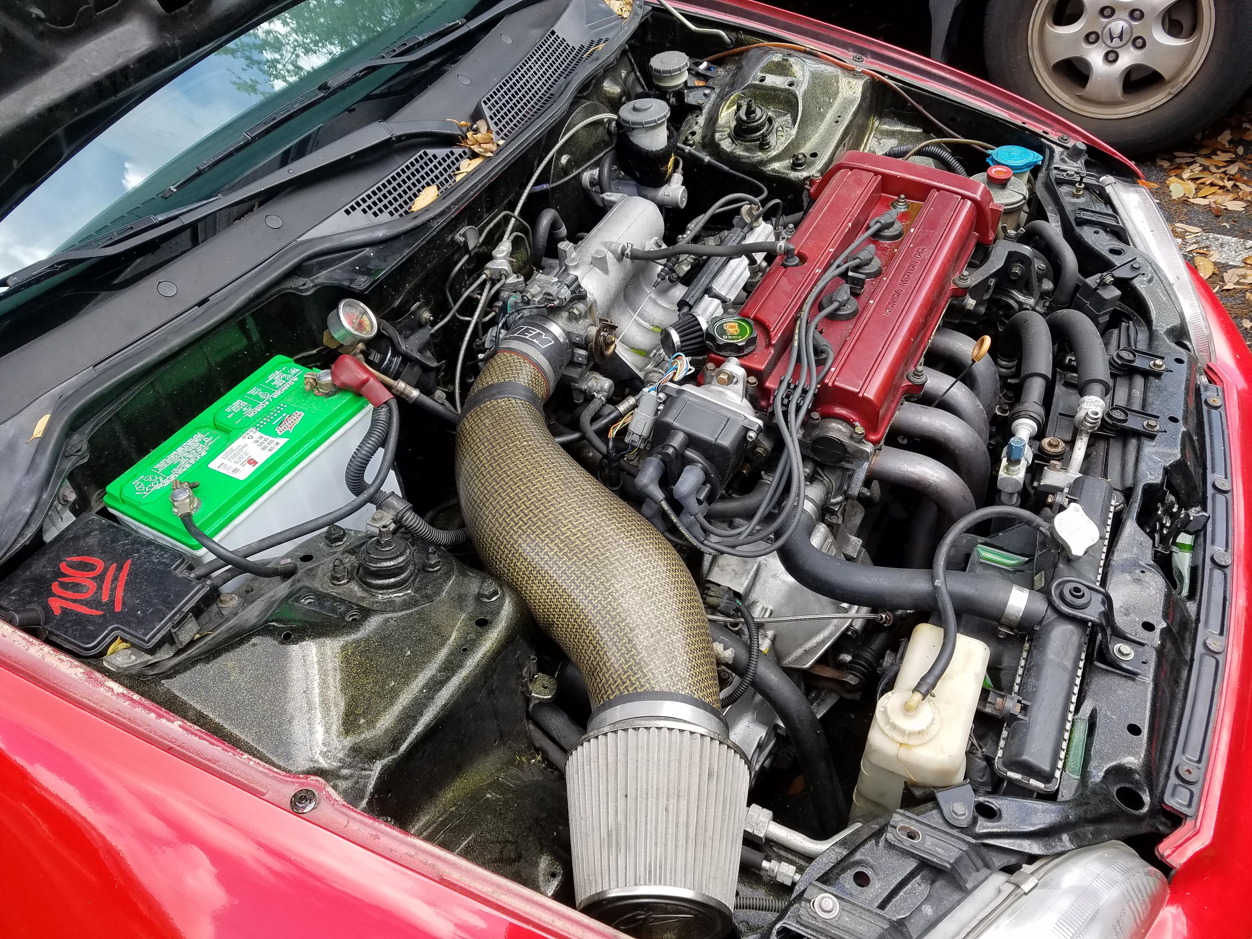

How can I check what model B20B engine I have? I know it's from a CRV but I'm not exactly sure what year and the mechanic needs to know before we order parts for it. I need a radiator and a head gasket kit.

97-01 CRV used that engine.
Head gasket OE#12251-P8R-004 is used on all those years. I did not check any of the other gaskets though.
If you need to know an exact year, do you know who did the swap and can you ask them?
Radiator is for the Civic not the CRV.

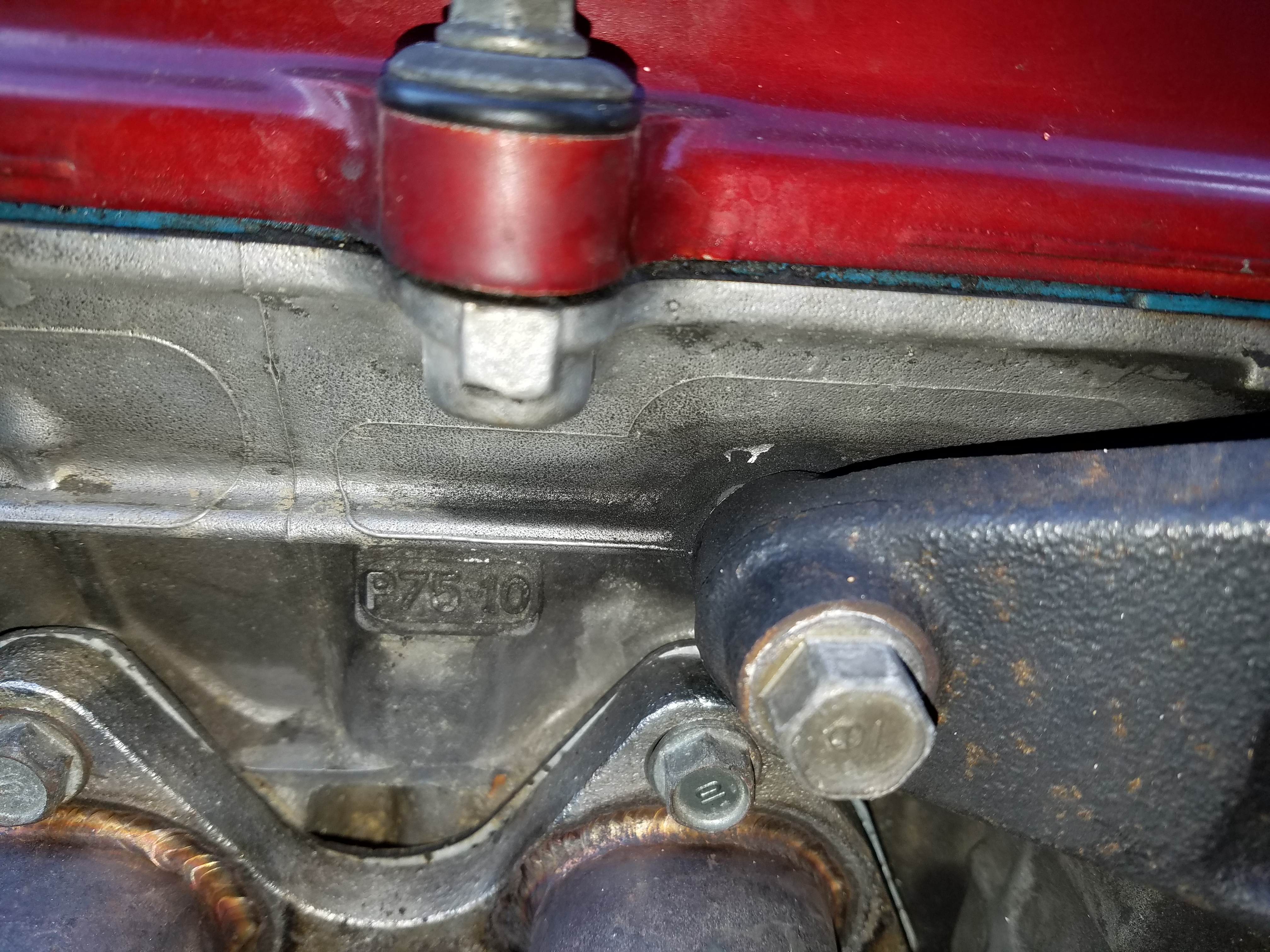

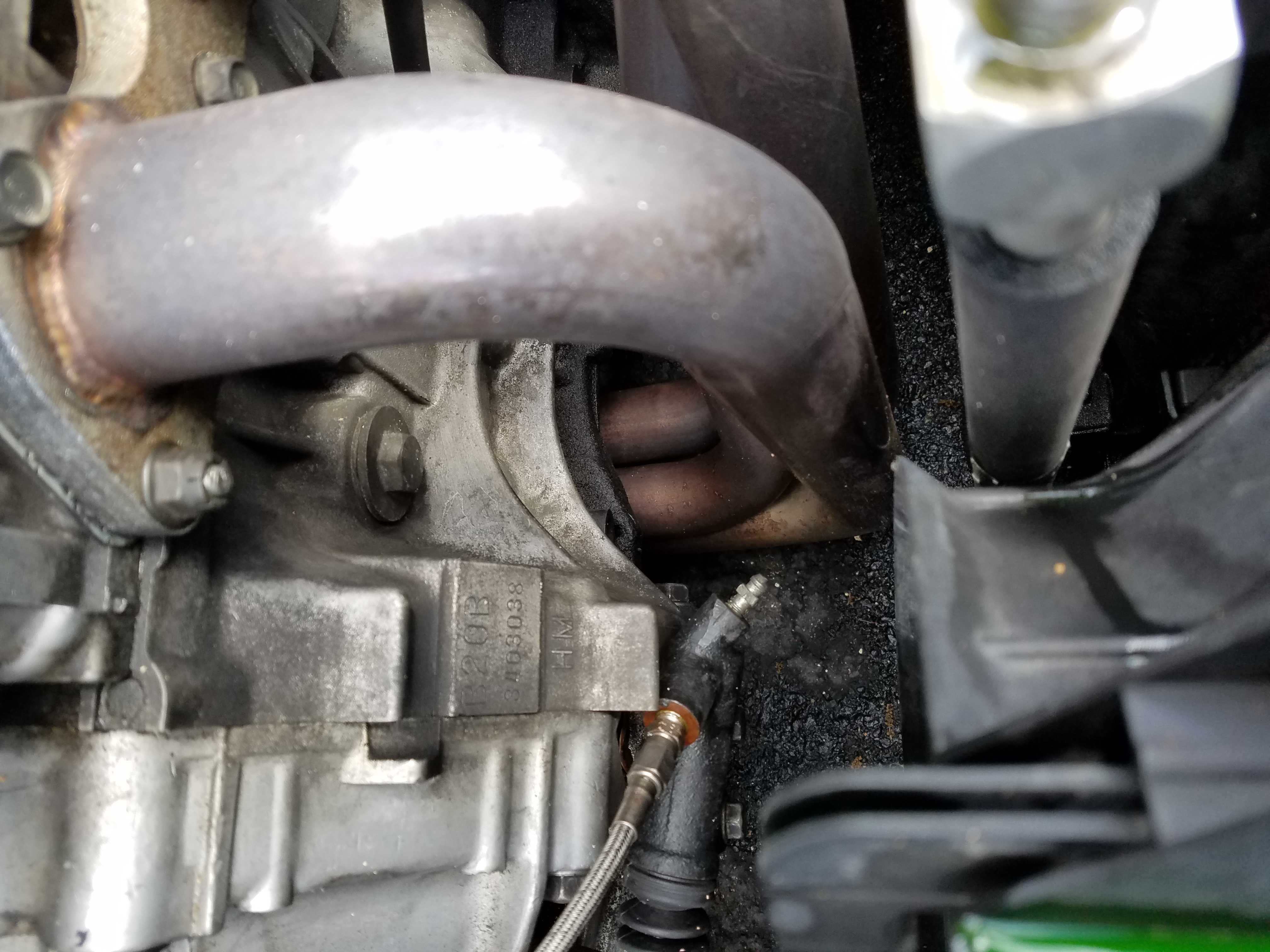

Hey so I found this it says p7510 I thought it was supposed to be a p8r?
No clue from me. I mostly deal with stock stuff.
