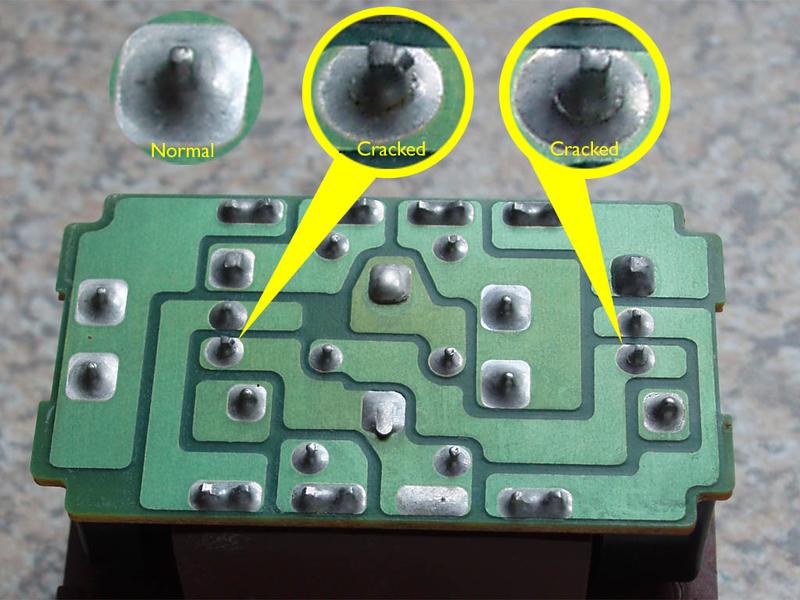

just a thought but caps don't have to be leaking to be unstable....
maybe when you have some time soak the entire board in 100% isopropenyl and scrub it with a qtip perhaps there's just some small bit of electrical conductive material causing a bridge somewhere on the board...focus on the IC legs.
Check the solder for broken connections too... like this
