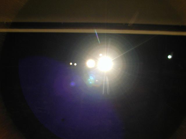

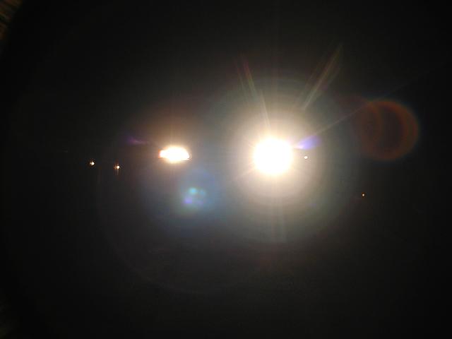

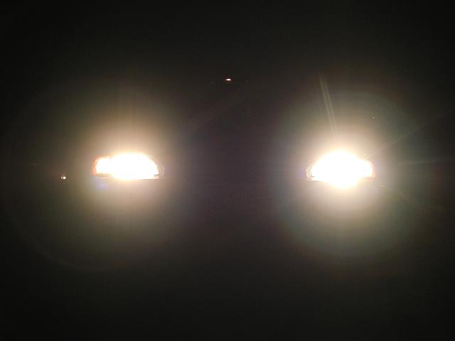

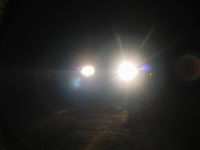

Got the Philips 9003XPS2 and installed them. Much better, but I think I need to aim the lights up a little. The light stops after about 80 or 90 feet.
The pics show the new bulb(driver) and the stock bulb(passenger)

ooh very nice. yeah i found that you need to raise the aim a bit. the philips xp has a much better focal point for lo beam compared to stock. but like any bulb replacement, usually the lights need to be reaimed. i noticed you have an older car, i bet upgrading the headlight harness to a new one with thicker wire and a new relay feeding the lights directly from the battery will improve output alot. just 1v more to the lights and you get nearly 500 lumens more light. you can measure the power at the bulb with the car running and it should be around 14v. if its 13v or less, a new harness will be a huge benefit. ive seen old cars sometimes barely pull 12.8v and the output was terrible. voltage and lumen output is an exponential relationship.
