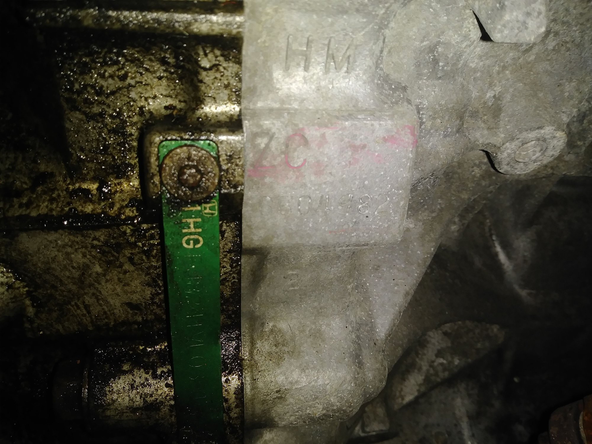

Here is some pics idk if thwy will help or not

Re: Please help!!! 1997 civic swapped motor an wont run now an d4 light flickers
Originally Posted by Sethdewey
What pulley you would call it?
Crank Gear.
Yes, there a notch in the crank gear that aligns with the arrow on block (near oil pump) when the first cylinder is at TDC.
Did you intsall a new timing belt, tensioner, waterpump?
Did you perform a valves adjustment?
Does anything have to be changed, or something I missed when swapping to that sohc zc
I have no idea..you did the swap.
Unfortunately, the particular swap you did is not well documented via internet threads. Most don't bother going down in power from a Vtec to a non-Vtec unless swapping for a larger displacement engine such as a B18, B20, etc..
A lot of research needs to be done prior to performing an engine swap or issues arise. Even with prior research issues can still arise. If, one doesn't have an experienced person guiding them things can easily go wrong. Do you know if you have the correct size/type of fuel injectors? Is the IACV a two or three wire, or same as engine harness? .
will the auto tranny work on the zc?
I don't have much transmission experience so hopefully someone else will chime in. Though the car in this link isn't a Honda it's a discussion about the subject: http://www.dsmtuners.com/threads/aut...l-trans.54436/ Reply #6 seems pertinent
