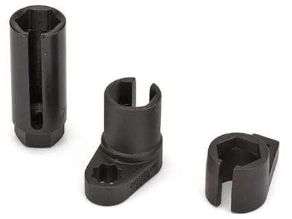

As it happens when I went to do the work I didn't have to change the centre section, only the rear. But not before I broke two bolts on the stupid cat shield. I was going to renew the centre section but the metal on the cat to centre pipe flanges looked pretty thin and well rusted together and thought I might break the cat flange if I tried to seperate them so didn't bother. That downstream O2 sensor looks difficult to get at too; is that a cat off job to change it?

There are a few different special sockets for O2 sensors.
Hope this pic works
