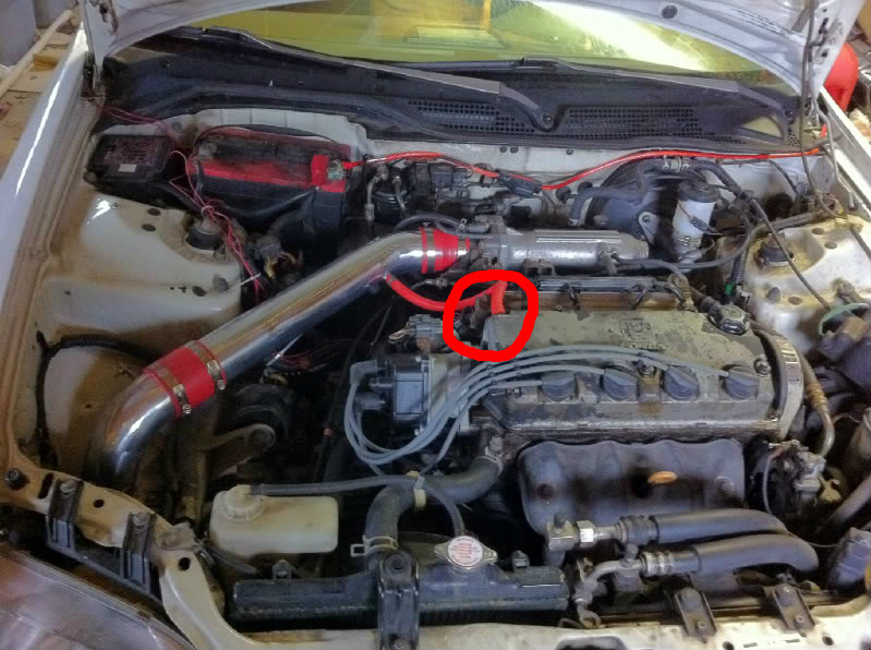

Your engine code is stamped on a flat pad on the block here:
Then look up what car it could have come from here
http://en.wikipedia.org/wiki/Honda_D_engine(If you don't have a D series engine, just google your engine code same as above)
VTEC valve is on the head here

ok. its a d16y8
does that make it a vtec also?
ok from the wikipedia link above, i have a vtec.

Should be, yes.
