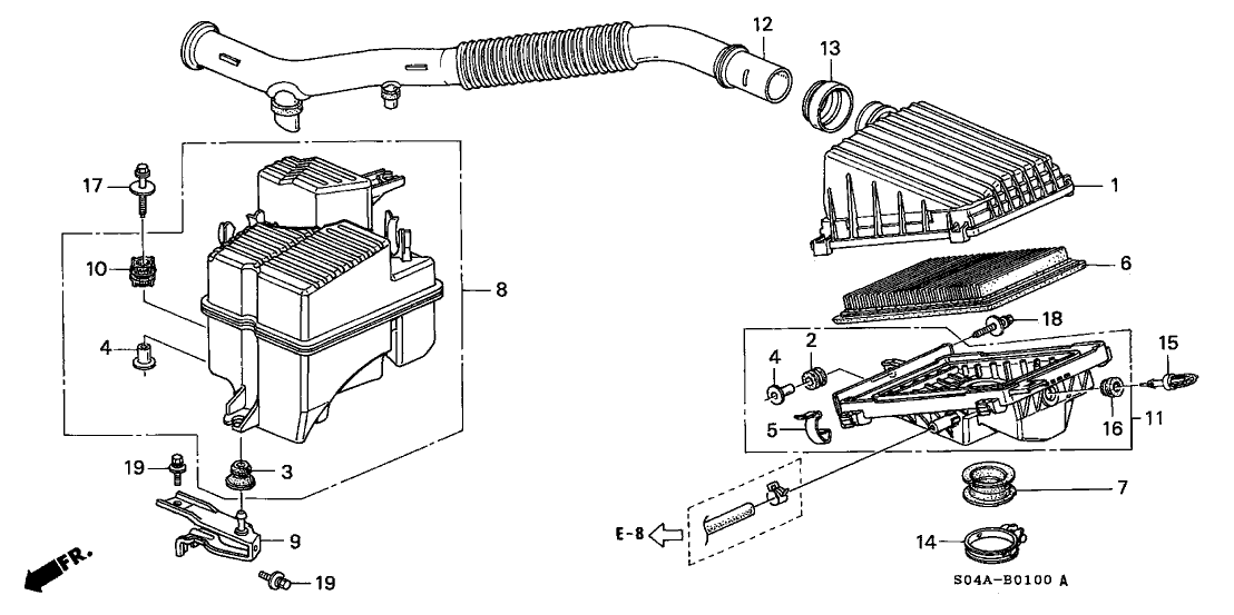

Hi guys. My wife's 98 Civic LX (D16Y7) is missing 2 air filter clips, resulting in an improper seal. On Majestic Honda's website, I'm seeing two parts listed, but I have no idea which to buy, or if I need both. The part I need is illustration #5:
It's showing two item numbers for the same illustration number:
17219-P2A-005 Illust. #005 CLIP, AIR CLEANER 2.71
17217-P2J-300 Illust. #005 CLIP, AIR CLEANER 2.42
Can anyone suggest which one I need to buy, or if it even makes a difference?
Thanks!
Old Apr 26, 2014
Rep Power: 517
Re: Help ordering the right part: air filter clip
According to my catalog.....
If your VIN begins with J (Japan built), use the P2A number.
If your VIN begins with any other character (1, 2, 5, North America built), use the P2J number.
