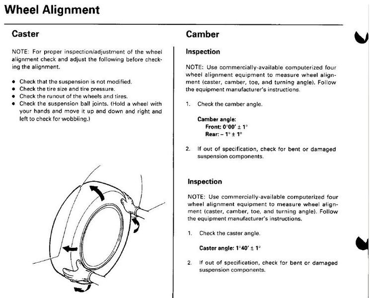

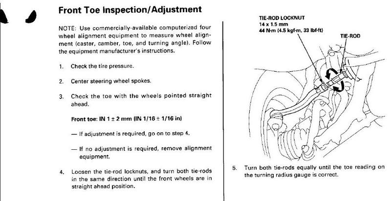

So I've recently replaced my upper control arms and lubricated my lower control arms. I'd like to check the wheel alignment to see if it's still OK. I just don't want to pay some dick to do it.
From what I understand on a stock 99 Civic there is no camber/caster adjustment unless there's damaged suspension components that need replacing. Tow adjustment is measure (with the wheels straight) the distance between tires front and back...split the difference and adjust the tie rod ends accordingly. Correct?
This is straight out of the FSM....
ID:	86075   Click image for larger version

I think it is best done on a floating type floor. 2 sheets of metal with grease in between them to allow the wheels to move freely. It's not needed but better for accuracy.

correct. also, since toe changes with the height of the suspension, the above mentioned method is best. suspension compressed is the measure to take.
