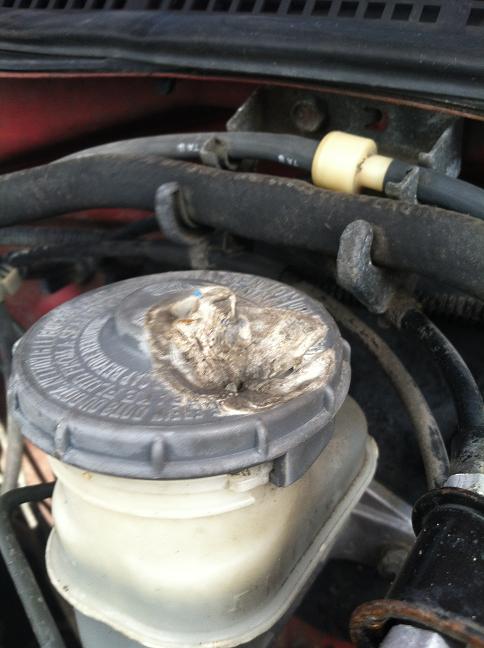

just found that my cap is melted and has 2 wires on it that are not connected to anything, will it be okay? or do I need to order a new one? also where does the wires hook up at.

The two wires are for a sensor in the cap, the monitors the brake fluid level, i bet with the wires disconnected the brake light on the dash will be on (!) . . .
I would replace it and are the wires disconnected on the cap side or main harness side ?I am not certain were they go from the cap but I sure some one can look it up

Found this pic of how it connects, maybe your wires fell down behind the strut tower area.

No brake light now, Thinking about just getting a Chrome cover to keep moisture out, since it seems like it doesn't effect the braking on the car.

Found the connectors, they was down beside the inner fender. But since I have no problems with the brakes, lights ect. I decided to save $30 and just filled the whole that was in the cap with some 60 Second epoxy nice water proof fix.
