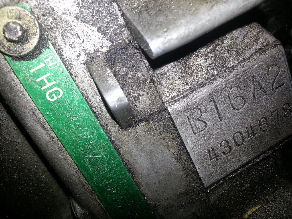

Its a B16 Name:  20130520_230048_zpsa803fbcc.jpg
But like I said, its my brothers civic, and unfortunately I don't think he can afford any kind of repairs, unless its literally "low-cost" which I highly doubt, as he works a part time job. I offered to purchase it from him, and pay for the repairs myself, but as of right now, I dont know what will become of this thing. I would like to make a project out of this and make a nice and powerful little car, within a reasonable budget, of course. Any ideas?

Haha yeah I went back to check out the engine, cleaned off some oil to take a pic, and sae it was actually a d17 lol

Re: BLOWN ENGINE!! Need Help!
A 2000 Civic does not have a 1.7 anything. 1.7 wasn't used until 2001 in North America.
Your pic from above shows a B16A2.

OP, you need a used B16A2 engine. The connecting rod for the piston is what came around and punched a hole in that block because of serious oil starvation to the entire engine. If you drop that oil pan, it'll be like the tv show Gold Rush Alaska and panning for gold. The whole engine should be considered a paper weight. And if, as you stated, you're not a mechanic and don't even know what the name and function of the engine parts are, how do you expect to do this rebuild yourself?
You need to buy a used B16A2 engine and have a professional mechanic install it for you, plain and simple. And if you can't afford all that then you need to find another means of transportation until you can.
