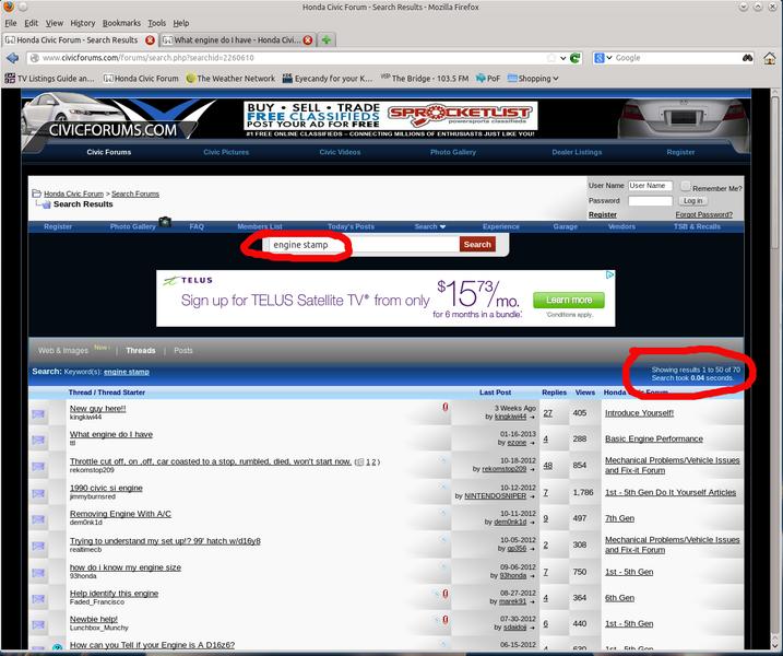

Alright, new to these forums and this brand of car in general. Appreciate the "google it" response but was hoping for something a little more informational.

He's (indirectly) telling you to look at the stamp on the engine. Right in front, look a out a foot below the top radiator hose
edit: Got home and did some googling for you, just to assist you in finding out what engine you have
On the pic below, that's the front (exhaust manifold side) of the Honda D-engine. Doesn't matter which D-engine you have, it's the same place for everyone (as far as I know, at least. Someone, please correct me if there's a deviation from what I consider the "norm"). The ms paint status arrow points to the engine stamp, which should be stamped with D1XXX. A quick wiki-search for "Honda D Engine" should help you figure out the rest, or at least tell you what cars that engine came in.
