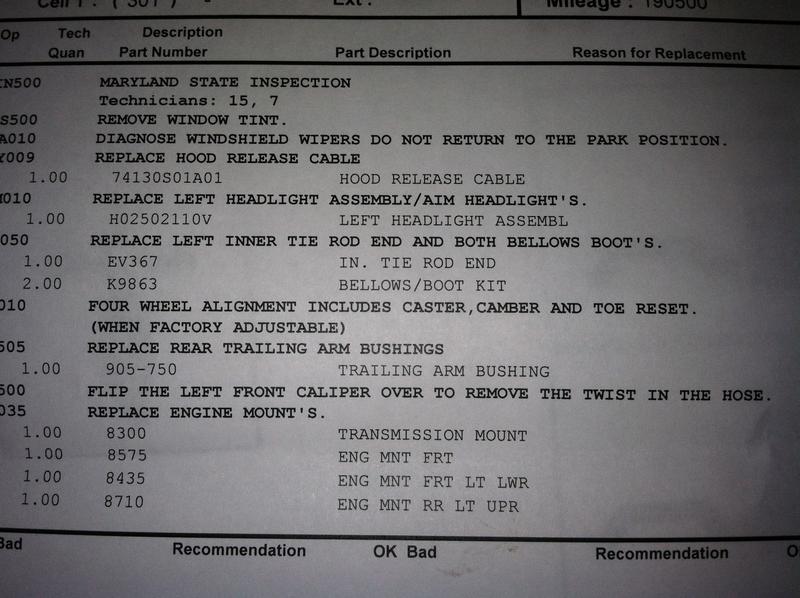

I got an inspection the other day and this is what they said (see picture) the total for parts and labor is a little over 2700$. Over priced? And what should I take care of first for safety? Wipers, tint, and headlight are already fixed.

Maryland has a tough inspection! I have had a few cars tagged in md. The suspension stuff is important, you don't want any of that to fail. Some of it you can do yourself to save some money. It might not hurt to get another shops opinion also $2700 seems like a lot!
Twist in the brake hose DAMN... who ever did that job before was retarted. Can break at anytime.

wow thats retarded inspection.
ive never seen a bellow boot need replacing, and im up north with lots of snow and salt

Hood release cable? I just use pliers to tug at the cable where the plastic thing broke off, surely that isn't required
same here i have a dedicated set of pliers in the car just for this purpose
