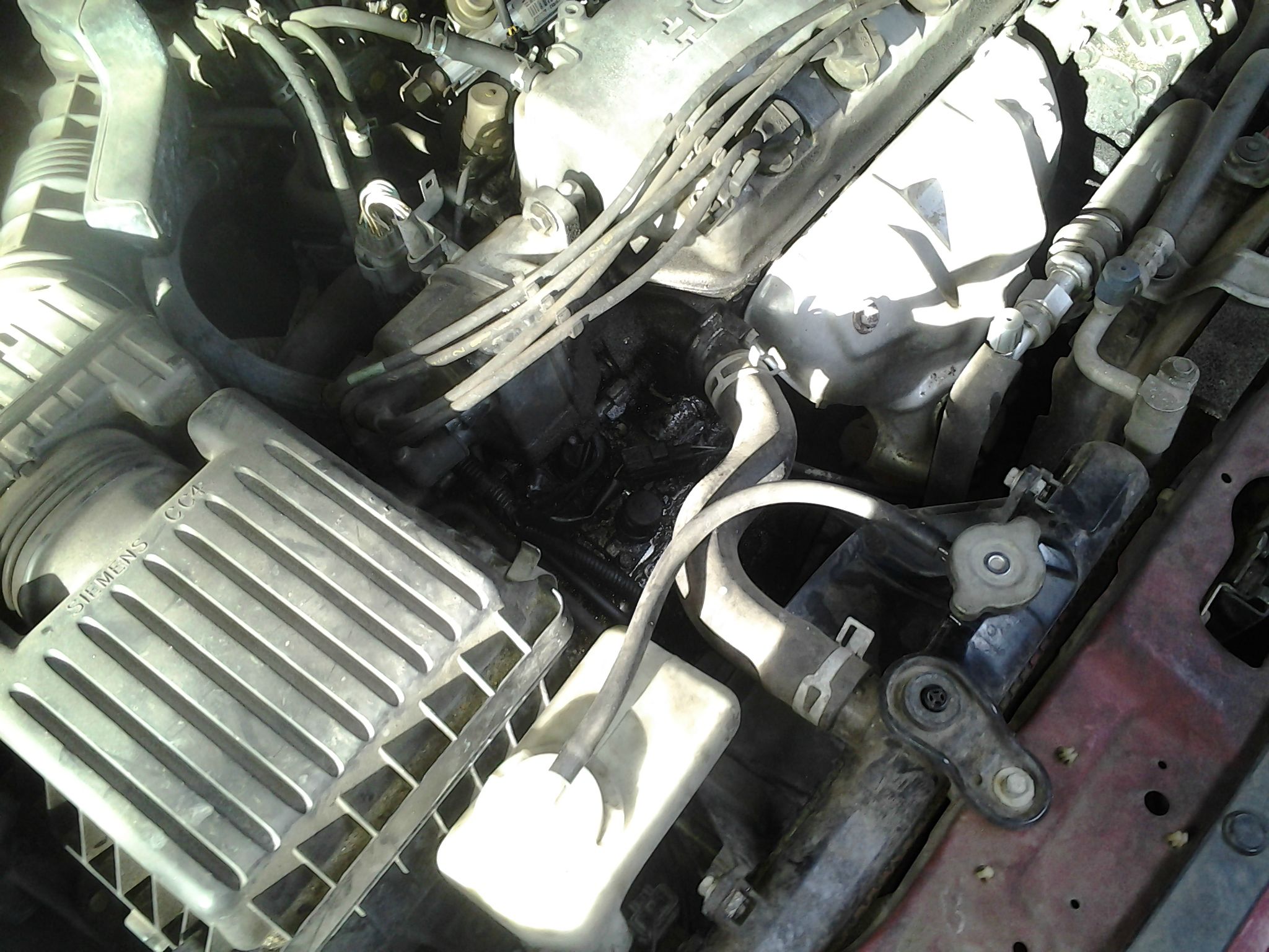

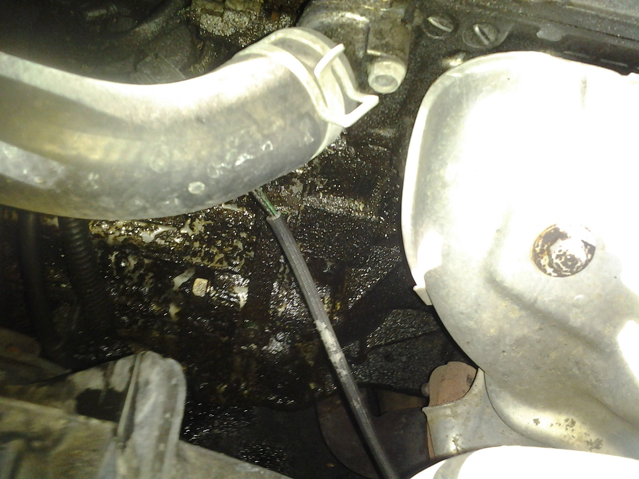

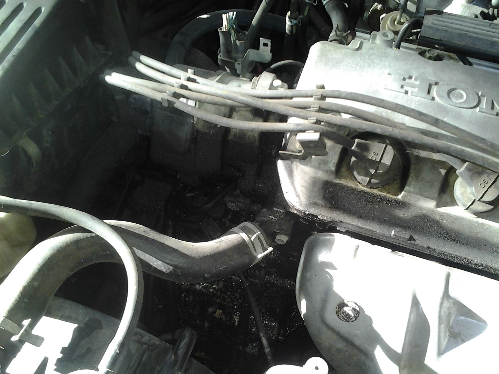

First off I don't know much about cars, but I do know its leaking oil because it rained and there was a huge oil slick, and there's oil underneath my car where i park it almost always fresh. My car's oil light went on too for the first time ever.
Here are some photos:

found it now what do i do
Old Nov 19, 2012
Re: How to take care of this oil leak!
Oooh, you need a whole VTEC valve.
Since you didn't say what your car actually is, I looked up a 98 EX 4 door.
They don't list the seal for the upper half, you have to buy the whole valve to get it.
#10 here: http://www.hondaautomotiveparts.com/...EAD+%28VTEC%29
Actually, look up your own car. Don't use the one I guessed at. http://www.hondaautomotiveparts.com/
Probably need the rest of any original rubber seals/gaskets replaced too: The O ring on the distributor, the valve cover gasket, etc.
HTH

I really hope you haven't bought the whole vtec solenoid because you can buy a new upper vtec solenoid gasket most of the parts diagrams don't have it listed and I have no clue why but I found the part number on line if i can find it again I'll put it up. I do suggest changing both gaskets though.

could be the distributor o ring leaking (2 dollar part at honda) I had the same thing in my hatch with a d16y8 in it.
