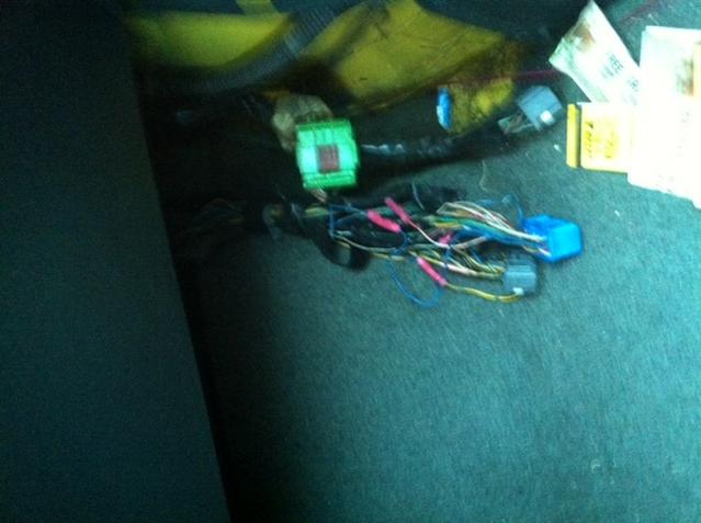

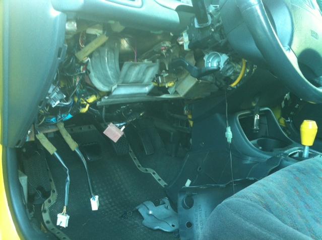

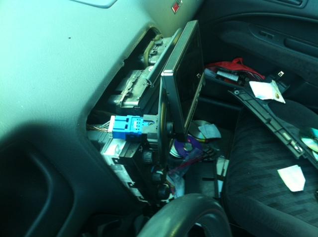

My 2000 EM1 Turbo was broken into a week ago , they broke my dashboard ripped out everything from the inside and only stole my Oil Cap from the motor , but the damage they did to was to my wiring , under my sterring wheel , things are missing , my fuse box is missing as well , and on the passenger side under the carpet something that has a connector which most people are telling me is the computer.. im not sure if to try to fix or just give up .. can someone please tell me what they did take .. and what i would need to fix it ? thanks everyone.
The 3Rd Picture is the passengers side floor , i want to know what that is if anyone can help

Re: Need Help From Someone who Knows about wiring EM1 Turbo
it is fixable but better have a good security system for nxt time, this time they take some components next time its the car and everything is loss.
i need better picture of everything that was rip apart,
fuse box you can find them at a junk yard from civic year 96-2000
its all plug and play make sure none of the harness is damage
other wise you will need to solder back together, and passenger right kick panel under the cover should be a sqaure box where the ecu is and if its missing then u need to find another ecu and if ur ecu is chipped and tuned for turbo then you have to do it all over again to run with your turbo '
