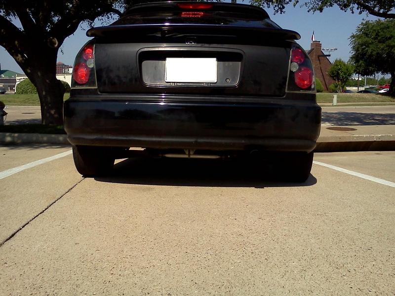

i bought some aftermarket tail lights and they're are fogging and collecting a lot of water, do i need new ones or what can i do to stop this?

Put your tail lights in the oven, open them up and reseal them. Those cheapo tail lights always fog up.

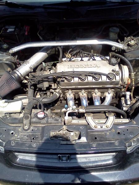

I'll tell you what engine you have and what the options are as far as building it. If your working on a budget and have moderate power goals you'd be better served keeping the d-series, saving the 5+ grand the swaps your thinking about will cost and putting that into the engine. I'm k-swapping because I cannot achieve the power levels I want on anything but a k, ithats the only reason.
Turbo'd engines are 100% daily driveable and safe, the rep for them being harder on your engine comes from ricer noobs buying ebay turbo kits and pushing their engines beyond the safe limits. It's all about good quality parts and keeping the boost levels within what your engine is built to handle. Building n/a is much more difficult and expensive to make less power.

Oem is best for lighting 99.9% of the time, you could make your own custom led tail lights, but that's a whole new discussion and a very difficult skill to master.

An engine code will be stamped directly on the block, look with a flashlight but it will be hard to see. The power that can be made with a D16y8 is amazing, I'm being completely serious, it's probably the best option for any budget build. In fact, it's the engine almost everyone i know uses in their race cars.

Without swapping you'll need a turbo kit, besides, driving a turbo car is amazingly fun. You have no intention of buying a cheap turbo, another pleasant surprise! I saw someone who turbo their car with pvc plumbing pipe the other day... Ugghhh...
anyway, hks makes good turbo kits, but I would just assemble one myself.
