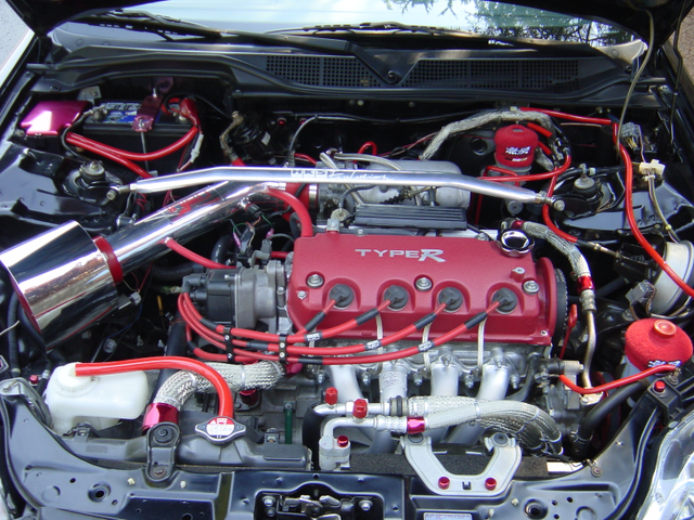

I just have a couple pics of it. I did take the stickers out of the windows since the picture was taken. I'm going to look for some wheels to replace those little guys.

Wow!
It definitely doesn't show how nice an engine is has from outside, I like the red colour scheme.
BoostedFalcon, would you like to have this thread merged with your build thread?

Obviously cared for ( I thought I posted here already but I guess I didn't or it got lost in the system )... Nice car!

ya that's a tight engine!
