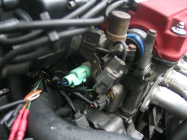

Look for the vtec solenoid. It's the rusty looking cylinder near the top of the pic. Those thick grey wires are distributer wires.

You absolutely sure about that? #10 sure looks like a vtec assembly to me: http://www.bkhondaparts.com/billkay/...itch=&hidIrno=

Look the picture above given by Lazlong and just tell us if you have it or not. If you have, it's a V-TEC engine...

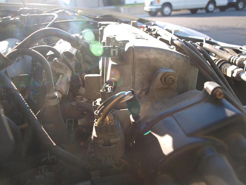

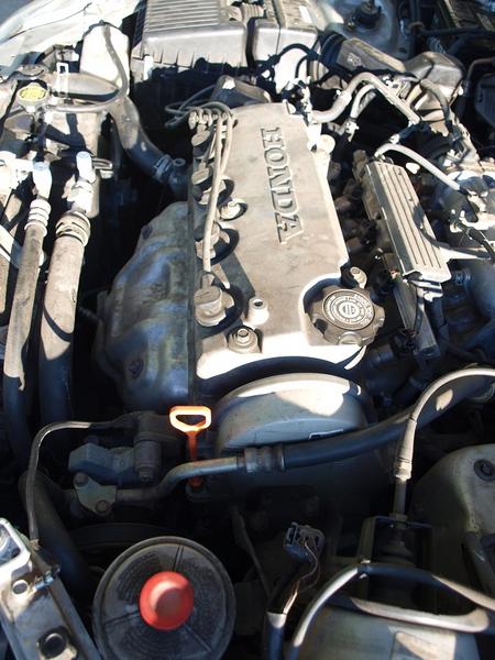

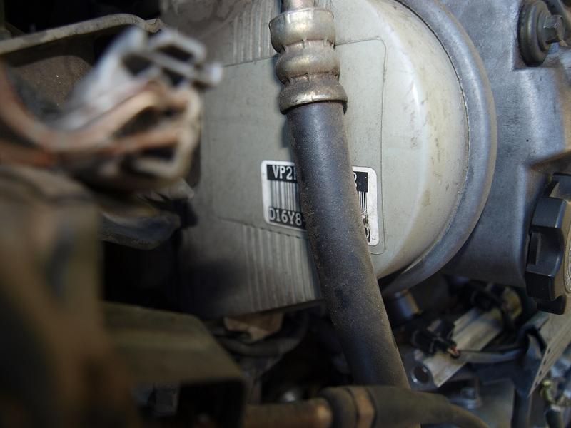

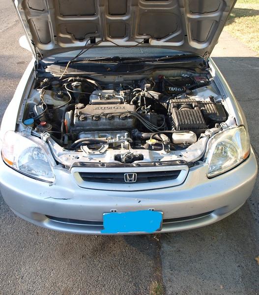

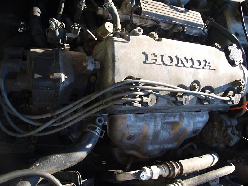

I HAVE PICS!
attachments?
There is a solenoid near the distributor on the block that's visible in two of the pics, for sure. Also a pic to prove it's d16y8.

Yupp its vtec, you can see the solenoid in the second and fourth picture. It is located right behind the valve cover on the left looking in from the hood.
Hate to burst the bubble but, that's a sticker on the timing cover that's probably from wherever they got the engine. You need to look on the block itself (a metal part) to see what engine it actually is. Or you could get the VIN off the block and go to Honda and have them do a search on the engine VIN.
