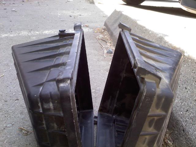

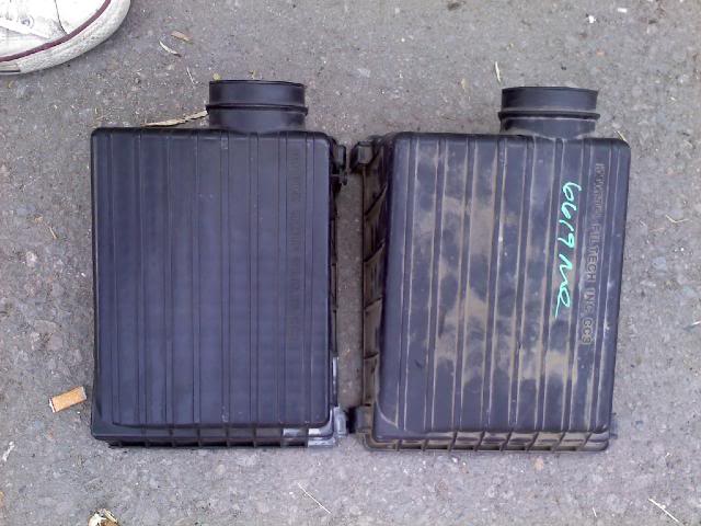

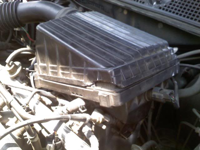

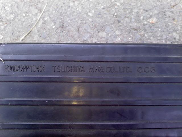

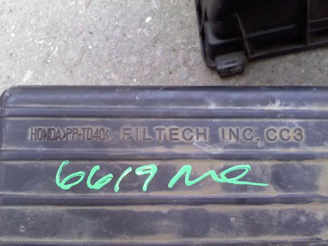

gio2323 is offline

did you make sure it had the same engine? i.e. looking at the stamp on the block like I alluded to earlier? There were 4 different engines they used in the 6th gen civic.. the D16y5 (HX model), -y7 (dx/lx/cx model), -y8 (ex model) and the B16A2 (Si model).. The y5 and y8 have the same air cleaner, while the y7 has a slightly different one.

Re: Can american parts fit into japanese cars?
dude the stamp says d16y7, so im sorry for being dumb. Thanks riceboy, helped alot. so one question, should i get the air filter cover on hondapartscheap.com but the one that costs like 11 bucks instead of that "japanese" air filter cover part that costs 60-70 bucks? would that fit?
