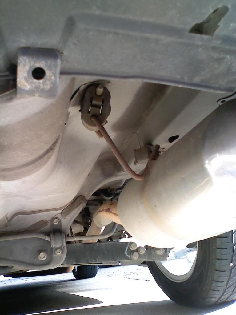

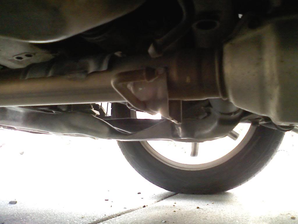

The hanger will be cracked/falling off.
See the 2 metal prongs? That is where the front hanger goes. As you can tell, I need a new one. lol Name:  hanger1.jpg

The back: Name:  hanger2-1.jpg

Really?
I'm going to check my prongs. No! I'm talking about the ones underneath the car. LOL!
I can't believe that's what's causing the noise but I'll check it out.
