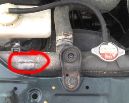

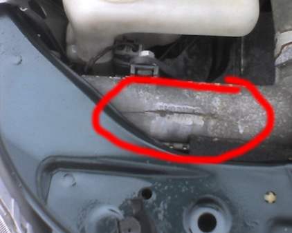

Radiator just began to leak, I'm letting the engine cool down before I dig in but I noticed what looks like a small crack on the top left of the radiator, which appeared to be a little wet. What are the chances that this is the culprit? If so, how difficult is this as a DIY repair for somewhat of a novice? While I'm asking, if it's beyond me...what am I looking at as far as repair costs for labor and parts?

yeah its cracked. try to sand the area, clean it up with alcohol, then use a two part plastic weld to seal over the crack. let it dry at least 4 hrs before using, preferably overnight. if that wont hold, its time for a new radiator. im guessing it will not be strong enough with all the pressure, but its worth a try.

plastic weld is easy to use. it comes in a tube at most auto store and has two parts you stir together and then spread it over the crack and let it dry.

I don't believe the cracked area is plastic, it feels like metal or steel
Old Jul 13, 2010
Re: Radiator Leak
ok okay its hard to tell in the pic. looked like that hard black plastic alot of honda radiators have. if its metal, they also sell metal weld kits and its the same idea of mixing the parts and letting it harden.

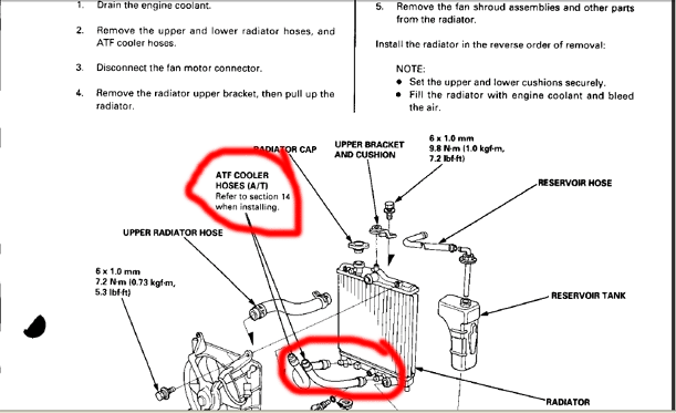

I checked the transmission fluid level as directed (2nd pic) and it did appear a little low SO where is this "filler hole" it says to add the transmission fluid to?

you are correct, the atf runs thru a small portion of the radiator to cool off (separate from the coolant). you can simply add more by removing the dipstick and pouring fluid into the hole. when looking at the engine bay from the front, it is on the left side under the factory air intake box. sortof near the fusebox and battery, but lower down.

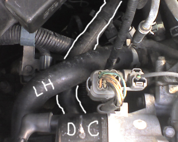

Upon further review, a hose (highlighted in white) not even attached to the radiator appears to be blown with coolant leaking out. This blown hose goes from the back moving forward underneath the Lower Hose (LH) and the Distributor Cap (DC) and looks like it goes into the bottom left hand side of the Cylinder Head.
What are the chances that this is just a strange coincidence that this other hose would blow 4 weeks after replacing the radiator & it's 4 hoses and not a sign of an underlying problem as mentioned earlier?
And BTW, what hose is this anyway???

Cant really tell by the picture on which on that is but the LH hose where it runs to the right behind the distributor is the thermostat housing.

Upon further review I went out and check my integra ls and that hose comes out of the firewall and goes to another hose. I am not to sure if that is a return hose or what. That hose either goes from the thermostat to the firewall and back out to the hose that you are talking bout and it goes into the engine head or it comes out that way.

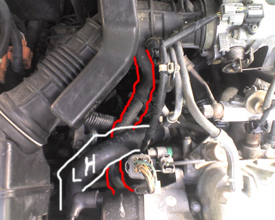

Does this picture help?

If you look at the post right above the one you just posted I figured it out lol. I made one post and then went out and looked in my other car which is a integra ls.

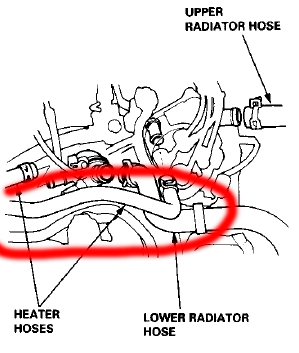

This is the culprit...One of the heater hose that goes from under the distributor cap to the heater valve. It split right by the clamp under the distributor cap. Problem is I'd have to at least take the entire distributor housing off, which I've never attempted before.
And looking at the other end that's attached to the heater valve, I'm concerned I may break the valve somehow trying to pull the old hose off and putting the new one on.
So needless to say, I'm not too confident about DIYing this one.
What do you think?
