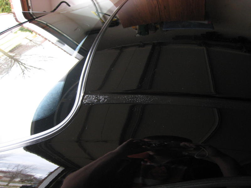

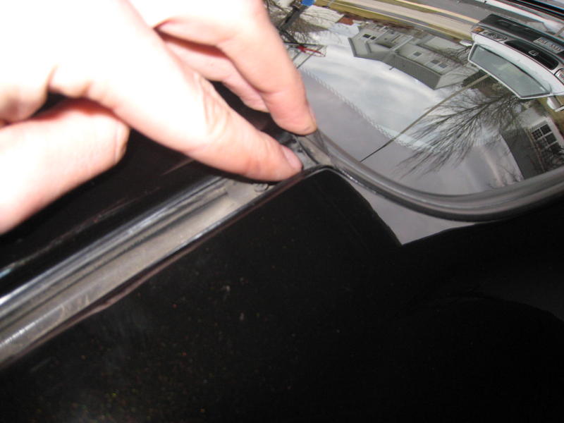

Your car sounds just like mine! Tho my mileage is worse. 190/tank . I had a leak in my trunk and I fixed it pretty easily. My leak was coming from the rain diverters on the roof. I took my out and followed it back all the way to the rearwindow. I lifted up the black trim a little bit and found a little hole (supposed to be there). Poured water directly into it and sure enough it was the problem. So I just plugged up the hole with heavy duty syclicone and the problem is fixed. I can send pics if you can't find where I'm talking about. Hope this helps. If not just try pouring water in individual spots and see where the leak is coming from.

Here are some pics. The passenger side is the one that leaked. I can't remove it because of the seal but the I took off the drivers side one to show you. I hope that helps. This is the first time adding photos so I hope I did it right.

Thanks, I tried that but mine is lower. Typically that is a sealed around the window, I'm surprised that stopped your leak. But like you said the hole is supposed to be there, it runs water around the window down to the trunk.
