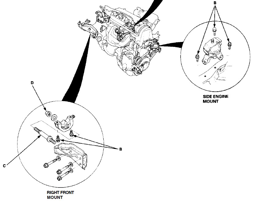

Hook up a scan tool to check whether the engine is idling to spec with and without the A/C load. Any CEL codes? When was the last basic ignition system tune up?
Did you check the two front torque engine mounts? They tend to fail by the age of your car. Did the rubber on the side mount crack, allowing the fluid to leak out?
Have you tried cleaning the IACV?
