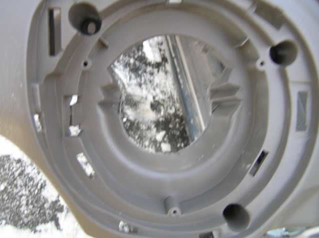

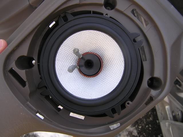

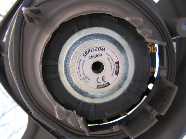

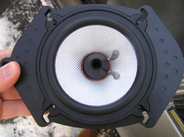

Can you take a few pics of the door panel and the speakers and lining up to the opening in the door so I can get a visual of your install.
You might want to try this, the mounting holes for the woofer, take a little piece of steel or alum. bolt it the speaker mounting hole and then extend it to the door's plastic then screw it to the door that way. I am not sure if you will have enough room to plant the tweeter to the woofer in order to mount the factory plastic speaker grill back on.
Sorry the photo's are a little large but I think you get the idea.
Re: audio questions
No offense, but you are making this more complicated then needed. The fit is not that off, just get a few washers and screw use 2 of the tabs and screw it into the plastic, as for the third screw (optional) use a small piece of flat metal screw to tab then extend it out to the plastic and screw it in. I would also check the tweeter clearance inserted into the woofer to make sure you can snap back on the honda speaker grill.

Wow, it sounds almost too simple, haha. But you're probably right; I will take some more pictures tonight, I have a boatload of screws and washers at home. I was thinking that I needed to have a bracket somehow, didn't know you could just bolt the damn thing right into it. That makes everything a whole lot easier..
