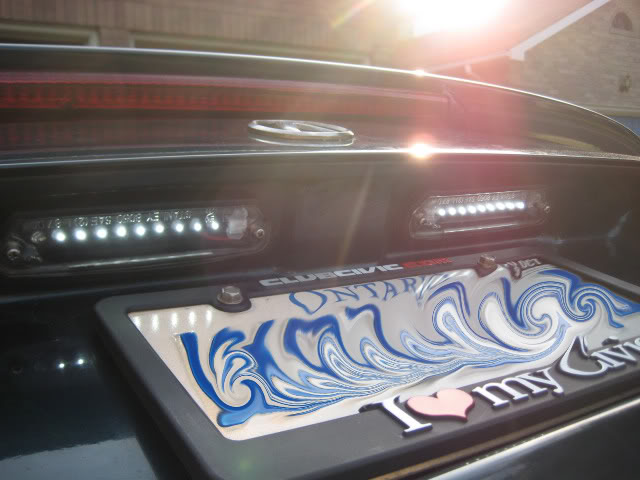

Okay, here are the pics !
Nothing big, like i said, but i like it
nice man i like it. my friend had a pink one til she got pulled over and cop said it has to come off lol. so enjoy while you can. i had blue underglow neons and got pulled over the first night i had em on
lol that sucks
Actually, i checked my local laws, and license neons as well as underglow neons are both legal here, as long as they don't pulse or pivot.
