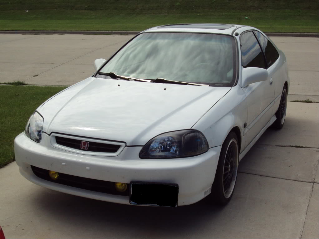

don't get the projectors...they are really cheesy. I had some and they got really yellow and started to peal. I replaced them with some cheap headlights from http://depoautolights.com/ As far as the bulbs, I would go with the hyper blue just because HID's are expensive.
