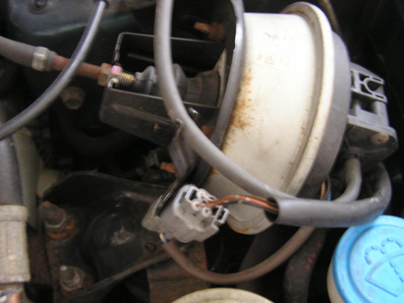

My dad came out the other day and fixed her in 2 minutes. He looked under the hood, saw 2 wires weren't clipped together all the way, and ta-da! she's fixed.

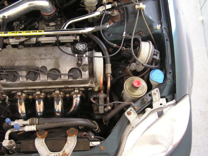

Here's a picture of the clip that wasn't fastened. Can anybody tell me what that thing is in the second picture?

the big round thing is prolly cruise control module. you can see a throttle cable coming out the left side. not sure what that plug is for tho, could be anything.

Interesting, seeing as the cruise control doesn't work...yet when that clip on there was unplugged, the car wouldn't start...
Anyways, thanks, I was just curious
