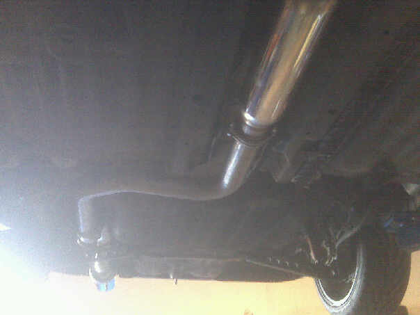

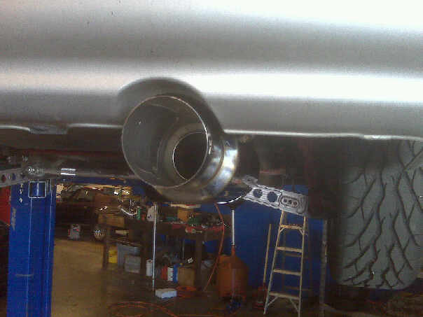

I've been thinking about doing this also, but I was wondering if I go with Integra parts would I still be able to use my Skunk2 Lower Control Arms?
Old Sep 15, 2009
  #49
crayzd's Avatar
Joined: Mar 2009
Posts: 16
From: Arizona
crayzd is an unknown quantity at this point
Re: 96-00 ex rear disc conversion?
Yes you can, I did, check the pics. Skunk2 lower control arms, tie bar, megapower r exhaust and 97 Integra trailing arms.
