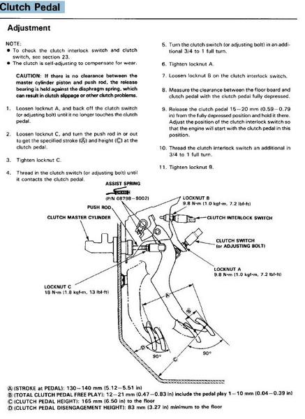

Try adjusting the pedal per manufacturer's procedure.
Originally Posted by micco
2) There seems to be alot of play in the shifter when in gear, i've replaced the bushings, but it seems to be in the shifter itself, any ideas?
I suppose it could be the shifter but if you replaced the bushings then the shifter should be fine. Which bushings did you replace? Have you checked the connections where the stabilizer bar and shift bar connect to the tranny and the shifter?

The clutch pedal engages right at the top, so if you press the pedal about an inch the clutch engages...
