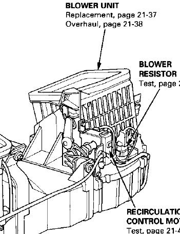

Re: DX Fan not working
The blower fan resistor is behind the glove box on the 96-98.
