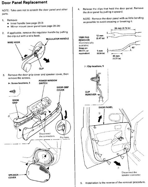

Get a panel popper at napa they are less then 10 bucks. The panel is just held in by clips and you need the panel popper to shimmy in there, strattle the clip, and apply some leverage. Then the clip pops out and you move on to the next one. There are several clips around the window. Then you need to lift the window up because it hangs on the door- also automatic windows and door locks need to be detached/unscrewed. Best bet- unscrew everything, pop the clips, and then lift the pannel up.

Re: Door panels
This picture may help.
