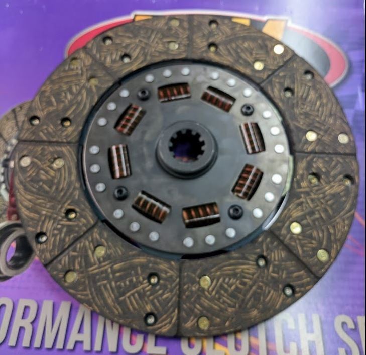

if you up the HP and NEED something grippy and capable of handling much more abuse, i recently bought a ram powergrip and what sold me was that they have "polycoils" instead of springs and there are eight of them instead of four or five. each polycoil can supposedly handle 3x the shock-load of a standard style spring. my abuse tends to break springs and wallow out their perches, which spreads the center of the disk apart. once you get a gap there, it usually leads to the center of the disk stripping out and a car that acts like it's in neutral.

can u post the link for it and ill check it out, thanks
