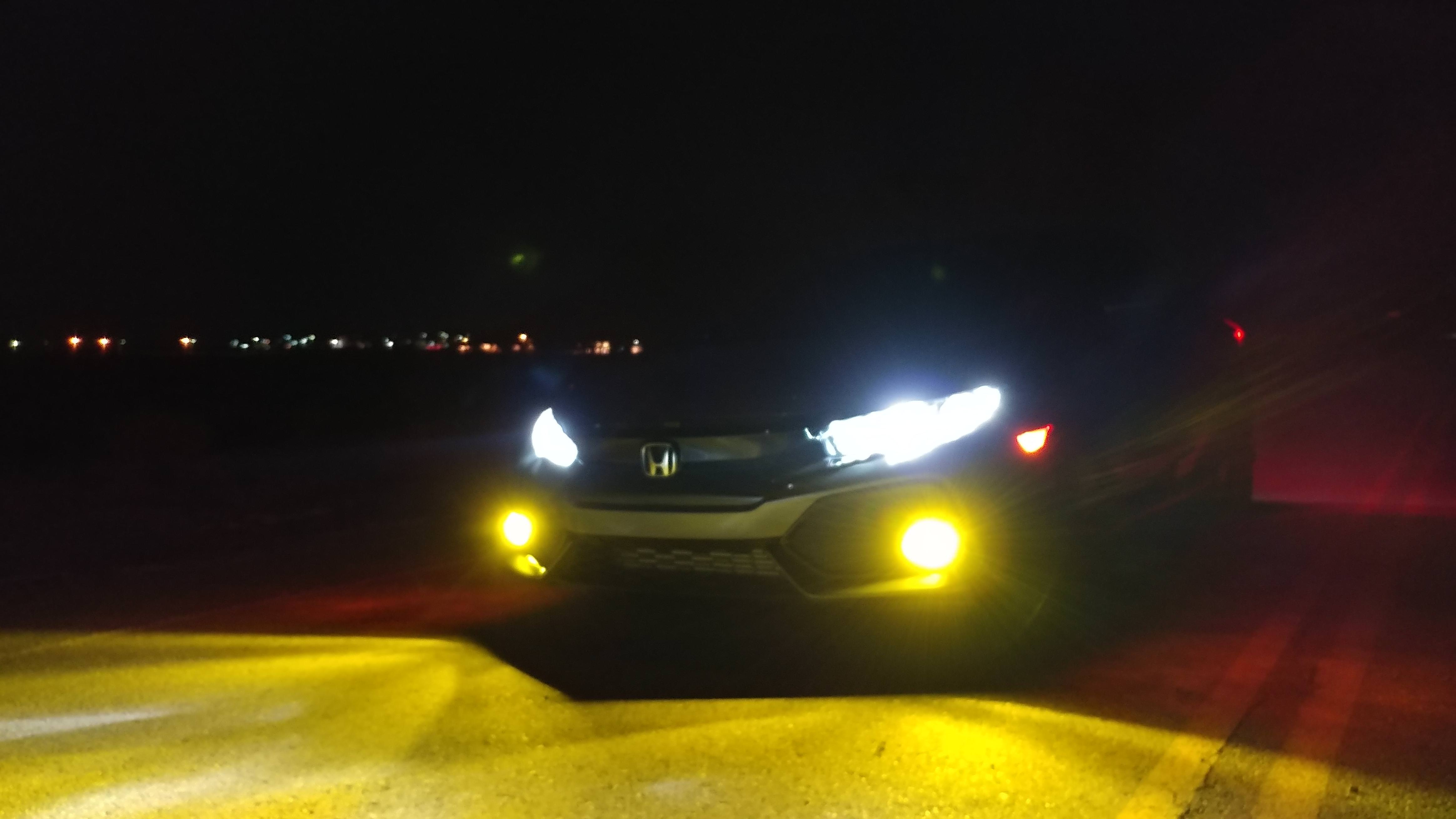

But, to answer your question, this is what my car looks like now:
and an artsy *** night shot after I installed yellow fog light bulbs and HIDs

She's a 2018 Civic Sport Hatchback with the 1.5L turbo engine. Thing's a freakin blast to drive.
