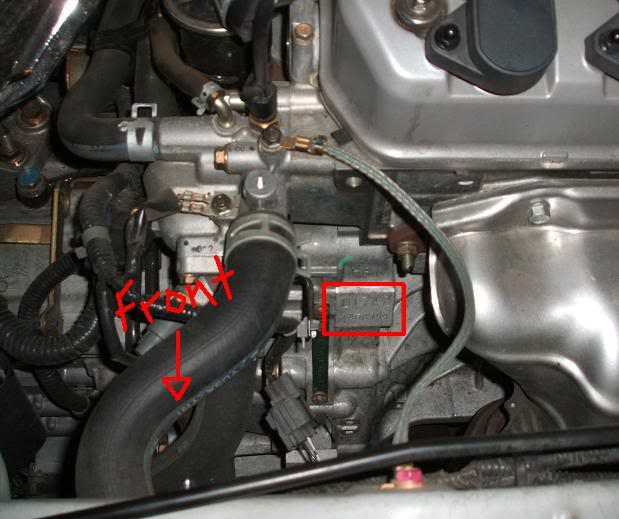

Trying to figure out what model so I can get the right head if I order one
Old May 28, 2016
Re: i need help
Engine code will be stamped on the block here
D17A1 = non vtec
D17A2 = VTEC
