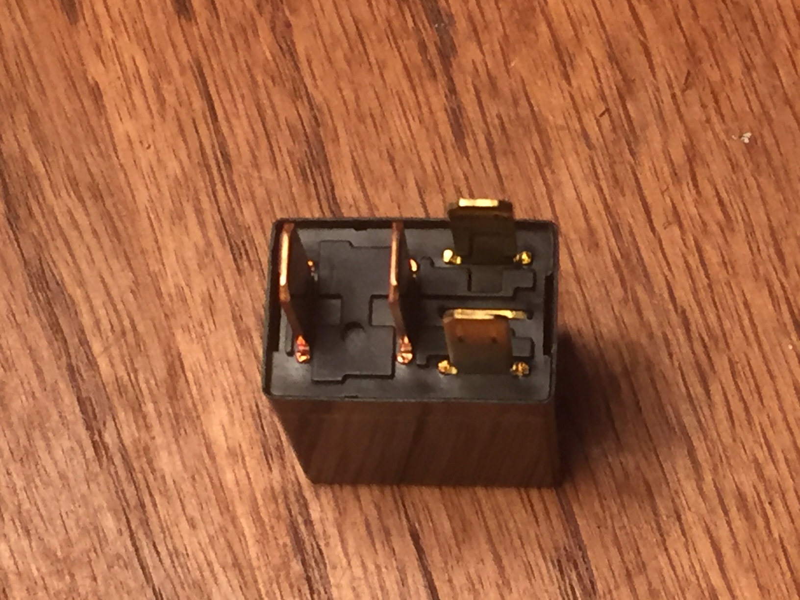

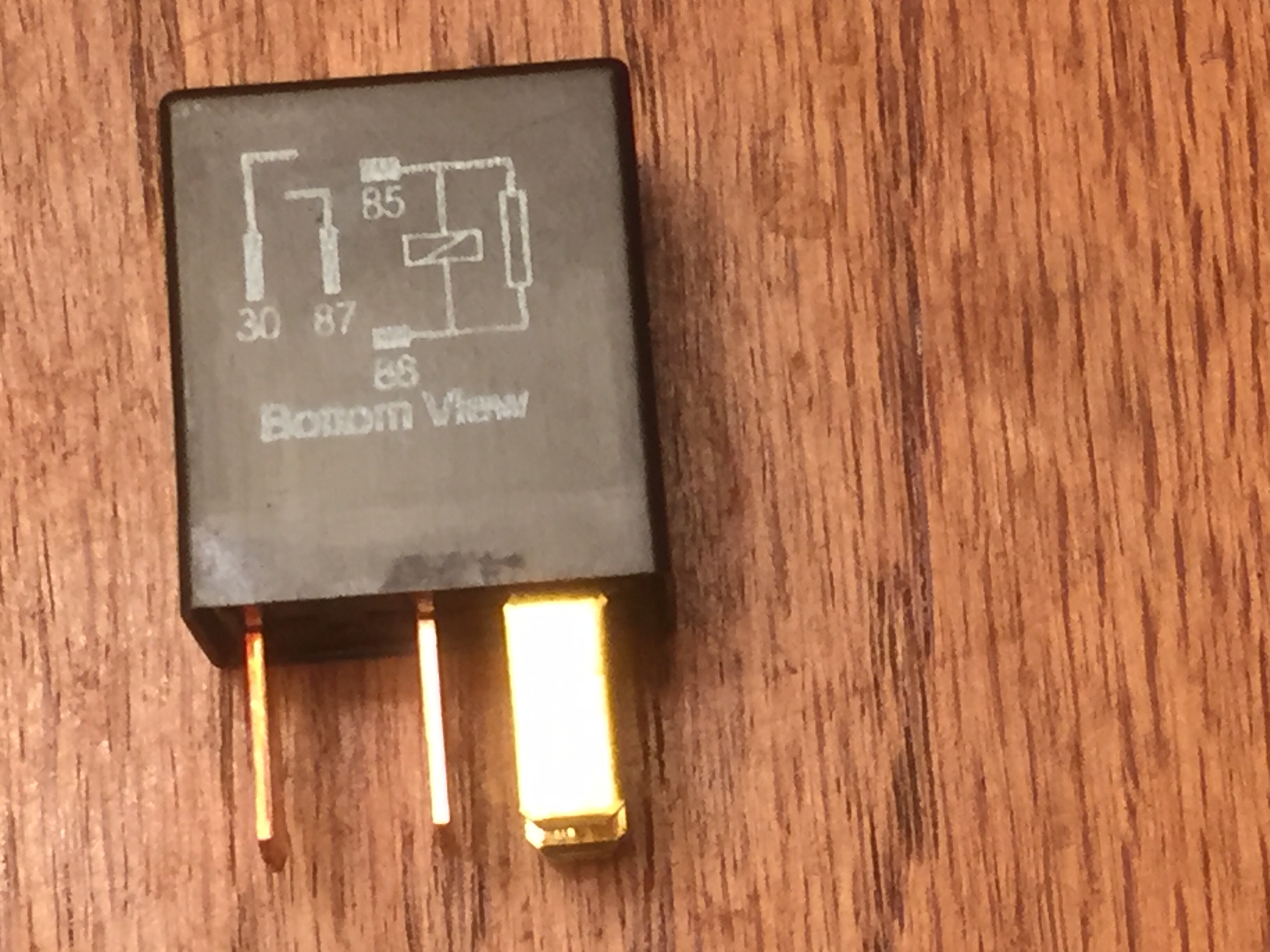

I'm having a similar problem with my Civic where the compressor is not kicking in. Could you explain how you jump the relay? There are four probes on this relay, assuming we are talking about the same thing. thanks.

You would only jumper in the socket you pulled the relay from, and you ONLY jump the two wide terminals (labeled 30 and 87 on the relay shell in your picture).
This is done to power up the field coil for the compressor clutch for testing purposes.
If you jump the narrow terminals in the socket (85-86) you're gonna do some expensive damage.
