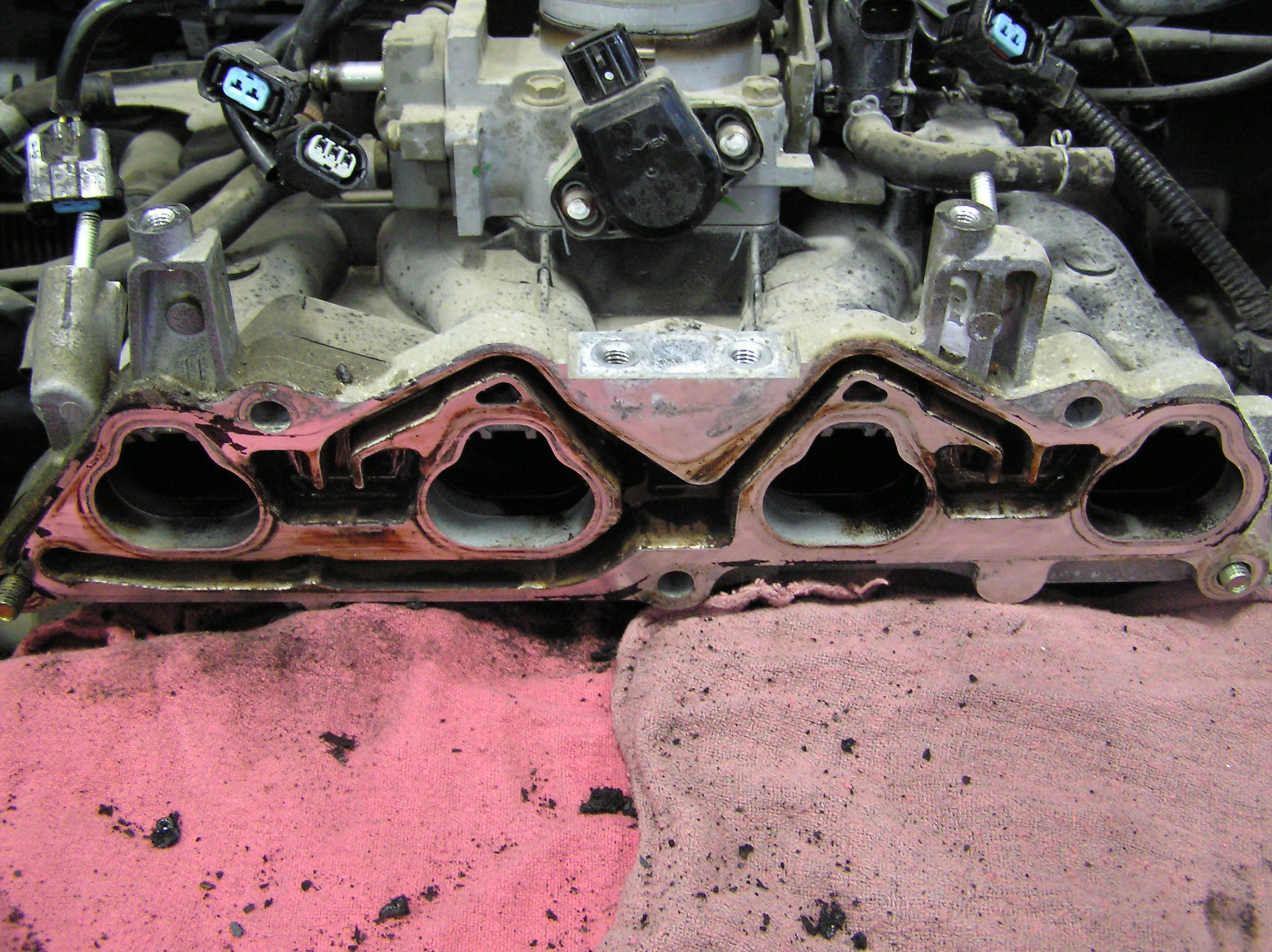

Good job on including the freeze frame data!
The typical P0401 issue is caused by clogged EGR distribution passages in the plate that holds the injectors. Requires removal of the intake manifold.
Usually this engine will develop mysterious misfire codes as individual passages clog up too.
Rare IMO to have a problem with the valve itself.
If this car had a very very recent head gasket replacement, someone could have installed an incorrect manifold gasket which blocks the EGR passage at the head.
