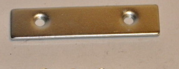

you don't need to remove the pad, on some models the pedal come as one piece; the screws that come with the pedal are short because they assume you will remove it and drill, go to the hardware store and buy 4 longer machine screws, 4 nuts, and 4 like the one attached in the pic, and use the holes on the top and bottom of the pedal to secure it
