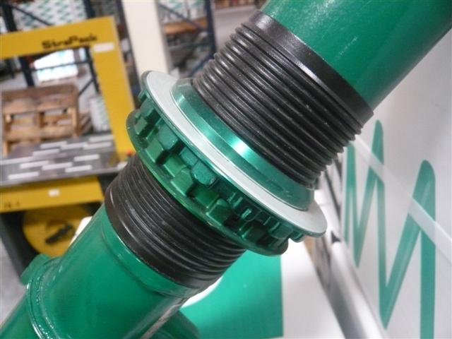

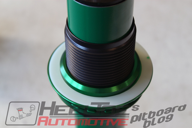

it looks they also Revised the spring seat to stop the springs from moving around. you mite have to also purchase a set of the new spring seats to utilise the thrust washers but im not certain you have to talk to tien.
I got that on mine already. Just need some good thrust bearings to help. I'm putting more silencer rubbers on the springs too.
