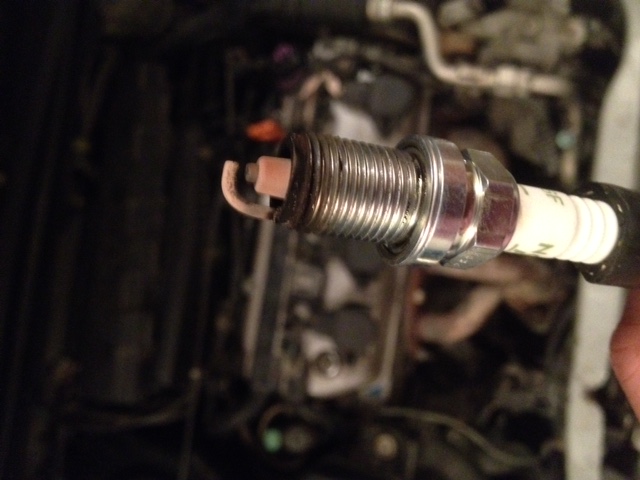

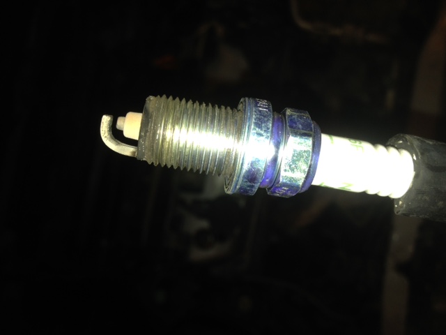

What did the old plugs look like?
What do the new plugs look like?
No deposits? No white crustys? No oily mess?
A cat can hide a lot of smoke.

and the plugs still look grey/white with no oil deposit's.
How long have you had these plugs in it? White or gray ash film or deposits would be from oil.
So just stick with the 5w20-30 synthetic blend you think would be best? Im in the Kansas City Missouri area, and ya it get cold here in winter 20-30 degrees sometimes.. These plugs have been in about 1k miles IF that, plug1 or first pic is with a flash, plug2 or 2nd pic is no flash.
You got the cheaper regular plugs, I see.
Kinda looks like the ground electrode has a little powdery white crust on it? No matter, just get more whenever they collect enough buildup to cause misfire.
Ya I just got the stock replacements because I didn't know what the problem was.. the spark plugs that I pulled out were black and had 4 ground electrodes on them?
