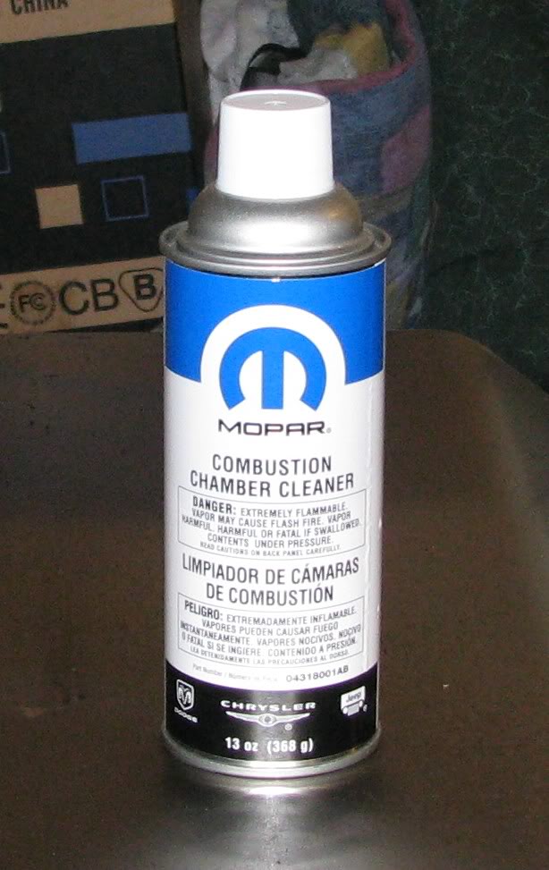

Re: 2001 EX manual oil consumption
The theory is right but the piston soaking is still a longshot IMO.
And if soaking, I'd fill the cylinders as much as possible with whatever I'm using. Don't want it all to run past the rings and have nothing left in the chamber.
One of the carbon eaters that really seems to work well is MOPAR combustion chamber cleaner. It's got chemicals that are hazardous in California!
I got some of this from the Chrysler dealer next door when I was doing a ring job, and I was pretty impressed at how well it worked. Now I try to grab all the partial cans I can find when I visit LOL.
I'd spray a bunch of this in the cylinders if I was going to let the rings soak.... (Might want to change the oil afterwards though!)
Old Oct 28, 2014
  #114
KillerCam251's Avatar
Joined: Sep 2014
Posts: 57
Rep Power: 142
KillerCam251 has a spectacular aura aboutKillerCam251 has a spectacular aura aboutKillerCam251 has a spectacular aura about
It's always the stuff that'll kill you that works the best

Ok so I've read about Seafoam, MMO and MCCC here. I would like to give one of these a shot here in two weeks when the car can sit for a couple days. Which one do you all think would have the best results.. the results being getting the oil ring broke free (if that's the problem) ?
I also plan on filling the cylinders up and letting it sit over night as well or however long is suggested. That being said, it seems like there are different procedures for the three different options here (Seafoam, MCCC, MMO).
I would like to NOT run one that will make the car smoke like crazy (I read I was suppose to add the Seafoam to the gas as well so it will smoke for a little while) if possible, but if that is the option that will yield the best results then I will do it. I guess like the rest of you, these options will be my last ditch efforts before just replacing the motor.. .which I don't really care to do.
EDIT: I found these instructions for the MCCC from a technician at Chrysler..
Mopar Combustion Chamber Cleaner/Conditioner is really good for removing carbon deposits, but the directions on the can are not so useful. The following directions outline the way that professional mechanics have been using the cleaner for years -- they were finally published in TSB 18-31-97 for 1996-98 Jeep 4.0 Liter misfire conditions:
decarbonizing Procedure
1. Operate the vehicle until the vehicle reaches operating temperature.
2. Remove the air tube from the throttle body.
3. With the engine at an idle, spray the entire contents of Mopar Combustion Cleaner, p/n 04318001, directly into the throttle body. Allow the vehicle to load up with the cleaner to the point of almost stalling out.
4. Shut the engine OFF after the entire can is ingested.
5. With the hood closed and the vehicle parked inside the garage, allow the vehicle to soak for two to three hours. This will ensure that the engine will maintain its temperature and will allow proper solvent penetration.
6. Drive the vehicle on a highway/freeway that will allow the vehicle to be driven safely at the posted speed limit. Upon entering the highway/freeway, accelerate hard to the posted speed limit and maintain speed. Slow down and then perform 5 to 10 Wide Open Throttle (WOT) upshifts. Continue driving at the maximum speed limit for 1-2 miles (if conditions allow).
If you guys were applying the MCCC to your motor, would you do this, as well as fill the cylinders up after spraying it through the throttle body until the motor stalls, and then letting the motor sit for hours or all night before hand cranking the motor? I have read that this stuff is an actual "foam" so there is no chance of hydrolocking the motor like you would with Seafoam since this compresses? I have also read that spraying this MCCC through the PCV valve/hose is better then through the throttle body because then it actually gets to ALL cylinders instead of the just a couple of them.
If its safe I would also like to add the MCCC (or whichever you guys suggest) to the oil so its on the bottom end of the pistons for SURE, drive it for a couple days and THEN run it through the top of the motor/let it sit in the cylinders over night. After running it and getting it all out of the intake and cylinders etc, I would change the oil, and MAYBE add another CD2 oil additive in the oil, however I haven't decided if I want to do the CD2 or not yet.
Forget that. It WILL smoke until all the 'fluid' has burned off.
The instructions you have up there are for cleaning a specific area, combustion chambers and valves. Your issue is not this.
YOUR goal is to get the bottom sets of rungs unstuck, therefore the above approach wouldn't work as well as directly filling the cylinders with the stuff and letting them soak in liquid. Start with a hot engine yes, but I'd just fill the cylinders.
JMHO
Yes it can come out of the can as a sort of foam, but it is still a liquid. Foam will turn back into liquid when it sits a couple minutes. A spray can sprayed into a running engine won't supply enough liquid to hydrolock SOME engines, BUT look at your intake manifold: It's not a straight shot into the engine, the chamber goes waaaay down so liquid will sit there and pool in the bottom....waiting for the first time you punch the throttle to ingest a huge gulp of liquid..
JMHO
I wanted to hit the pistons/rings from BOTH ends so that as much as possible can be cleaned out. I understand how to do the top side and soaking etc. I was just going to add some MCCC to the crank case (if its ok to do) drive it for a couple hundred miles, then do the top side, then change the oil and go from there.
Unless you all suggest otherwise?
About the intake manifold ya, I noticed that and figured that's why I would have to be giving it some gas (1500 rpms or so) while spraying in through the manifold or into a vacuum hose on the intake manifold.

As a combustion chamber cleaner i wouldnt run MCCC in the oil. If you want to run something in the oil do either seafoam or MMO
^What he said^
Mopars stuff is not for the crankcase.

Ok so MCCC for the top side only then. I have a can of seafoam, no MMO though. Is either of them better than the other or are they pretty much the same for what I am wanting to accomplish with the bottom end?
